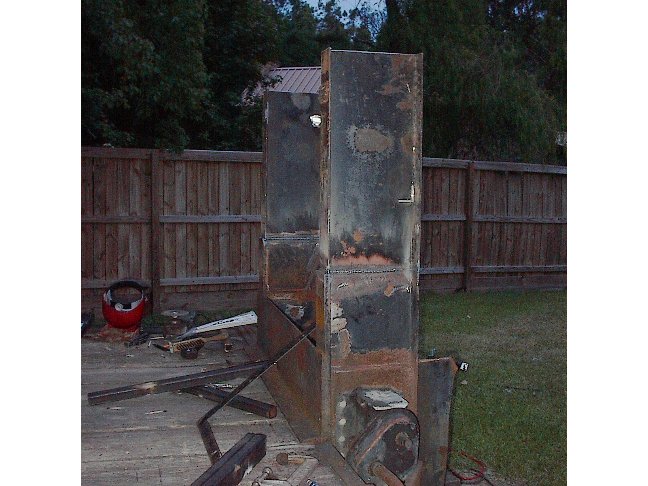

Got the uprights welded in with the 6011 root pass DC reverse polarity. Welds will get ground some and then a final pass with 7018.
Adding doubler plates both sides and then a boxing plate on the outboard side of each upright from the top down almost to the jack gearboxes.

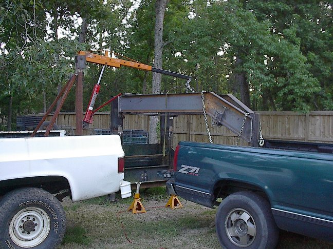

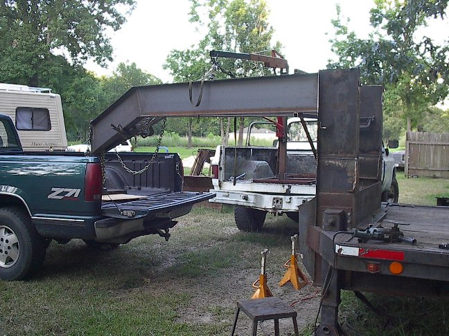

Well, I tried and I failed. Tried to hang it by myself since my buddy said he would help and then he left and went to the lake with his gf instead.
Wrestled with it for a long time and finally got it lined up and tacked except the left side lower had a gap and I thought that it would come in when i lowered the hoist some but it refused. Broke the tacks trying to force it down. Will need some more grinding to get the angle correct. Gave up as it was dark by then. Wont be off work to mess with it til wednesday. Phooey!!!!!!!!!!!!!
After its hung I will do all the doublers and crossmembers and gusetts.
Im pulling the air actuator and master out of it and will install a dexter electro-hydraulic pump- the 1600 psi unit for the Alko disc brakes on this trailer.
Its just sitting on the back of the 1/2 ton - dont intend to pull with that one :)
