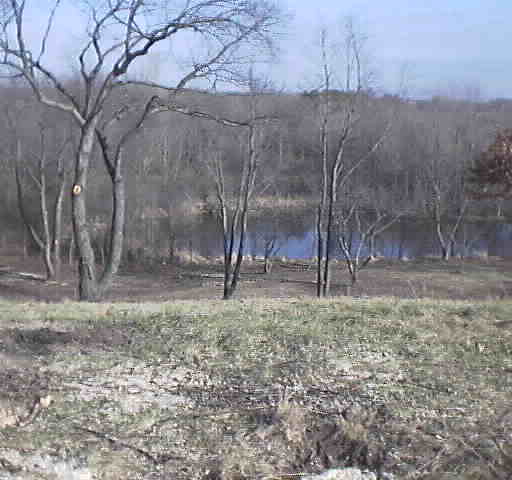

Wow! What a great idea! Our house-to-be will be at the top of a very high hill, and the septic will be between us and the corner of the lake the hill slopes down to. I've attached a picture of the freshly cleared (yesterday) hill. (Somehow the cheap camera makes things look scrunched up - it is quite a ways down to the water.)
Anyway, I am a real softee when it comes to critters, and I've been fretting a lot about the result of putting a septic field in there (where the engineers say it *has* to go. I worry about how drainage and leaching will affect them over time. Your idea sounds fantastic! Where can I learn more for myself about an aerobic system before I start talking to contractors? I'm all ears!

I found a good article about the aerobic septic systems at http://pasture.ecn.purdue.edu/~epados/septics/septic/aerobic.htm
As far as getting local information about them, I would call some of the local septic people and ask them if they install aerobic systems. You might also check with local chamber of commerce or the like for references.
I think it will be worth your efforts.
