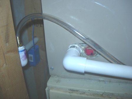

Ohhhhhh, I think my lightbulb just went off...
Ok, I've got my drain pan that used to be plumbed into a little sump pump. Now, the drain pan is connected directly to a 3/4" line that is connected to a bigger line, ending in the septic system.
Well (insert lightbulb)...
What if I removed the 3/4" drain connecting the pan to the septic system. Put the pipe back to make the pan drain into the sump. Then, instead of having the sump PUMP the water up/over and across the room (storing enough water in the line to flood my floor when the power goes out), I could get a new section of tubing for the sump and simply take it across and over to this drain that I have installed (the one with the gas smell in it)
What this would do is first... DISCONNECT the sewage connection to my air handler, it would bring back the sump pump and the risk of "flooding" when the power goes out (flooding defined as a several foot puddle), HOWEVER, instead of having 40' of current drain pipe connected to the sump pump, I'd only have maybe 3 feet going from the sump over to the drain tube.
I'd only need $5.00 worth of parts and if the sump ever dried out during winter months, I can easily put some water in it instead of having to disconnect the front panel of my air handler to feed water down ITS drain.
hmmm... yep.... me thinks I'm onto something.

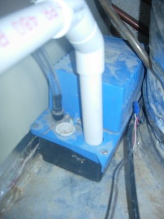

Though I intended on putting a picture up, I forgot to take it this morning :rolleyes:
I did the re-direct of water flow yesterday and I think it's going to work like a charm. Not only is the drain line now, disconnected from the air handler, there remains a plug of water (seal) in the line from the sump pump to the drain line, keeping any fumes inside the drain line.
I also think it's not going to flood back because I've dramatically reduced the volume of water being held in the old drain line.
While this was going on, my air handler was operating. I was very impressed (amazed?) at the amount of suction that it pulled from this drain hole. It's EASY to now see why it was sucking fumes back into the house. I even had the wife put her hand near the drain so she'd see how much air was moving.
If I remember to take the dang camera home (that I brought with me today so I could take the picture), I'll try to post one later. It will make some of the commentary clear (so I think)
Regardless... it's nice to have that smell evicted from the house.
   / Septic fumes in house
#18
Here's the drain out of the pan and on the left, you can see where it used to be connected to. This is where it was sucking out the septic fumes.
Now, I routed the drip drain back to the sump on the right and the outlet of the sump is the clear tube heading back to the drain on the left.
Working, or even better, SMELLING like a charm!! :rolleyes:
