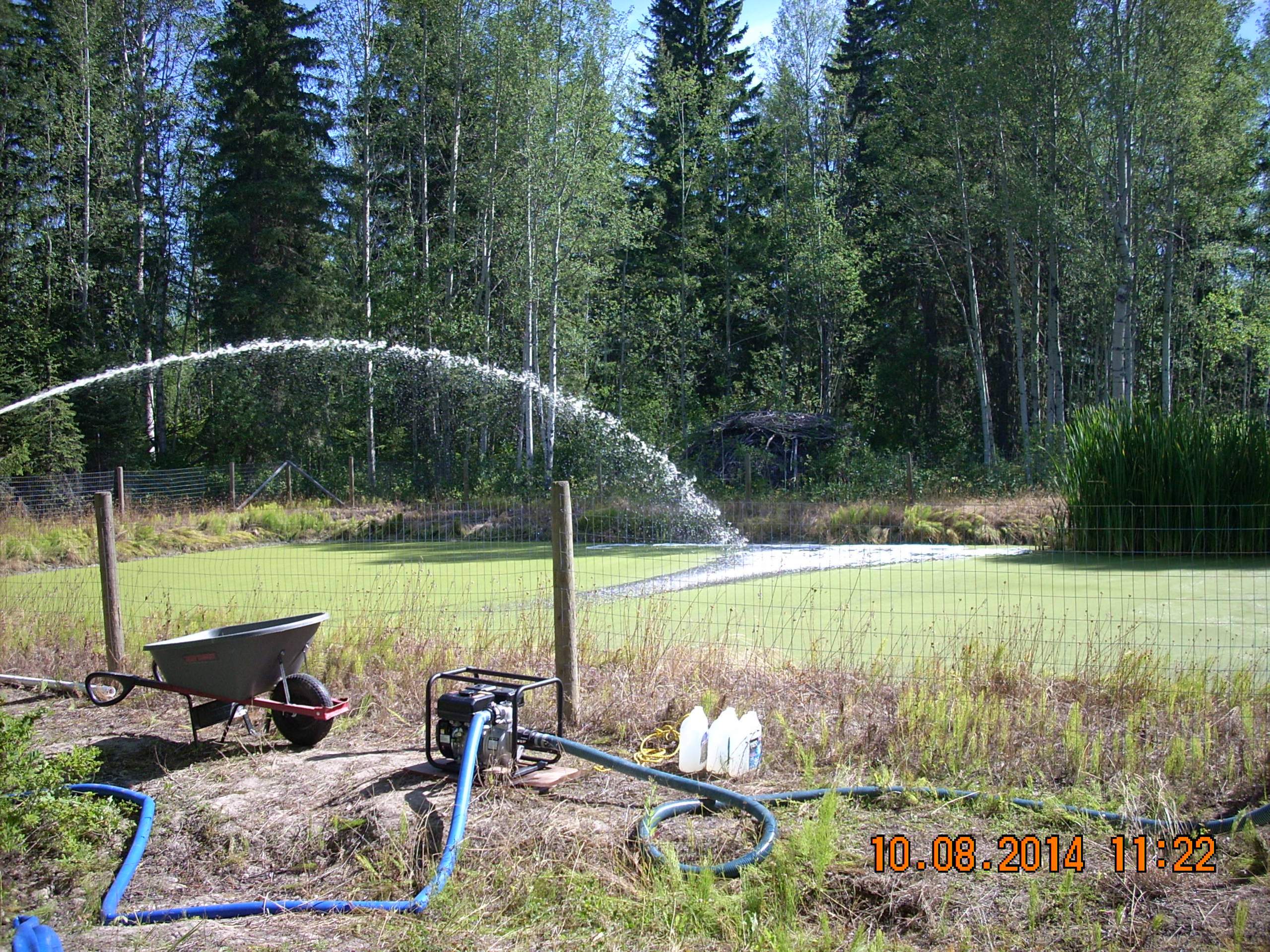

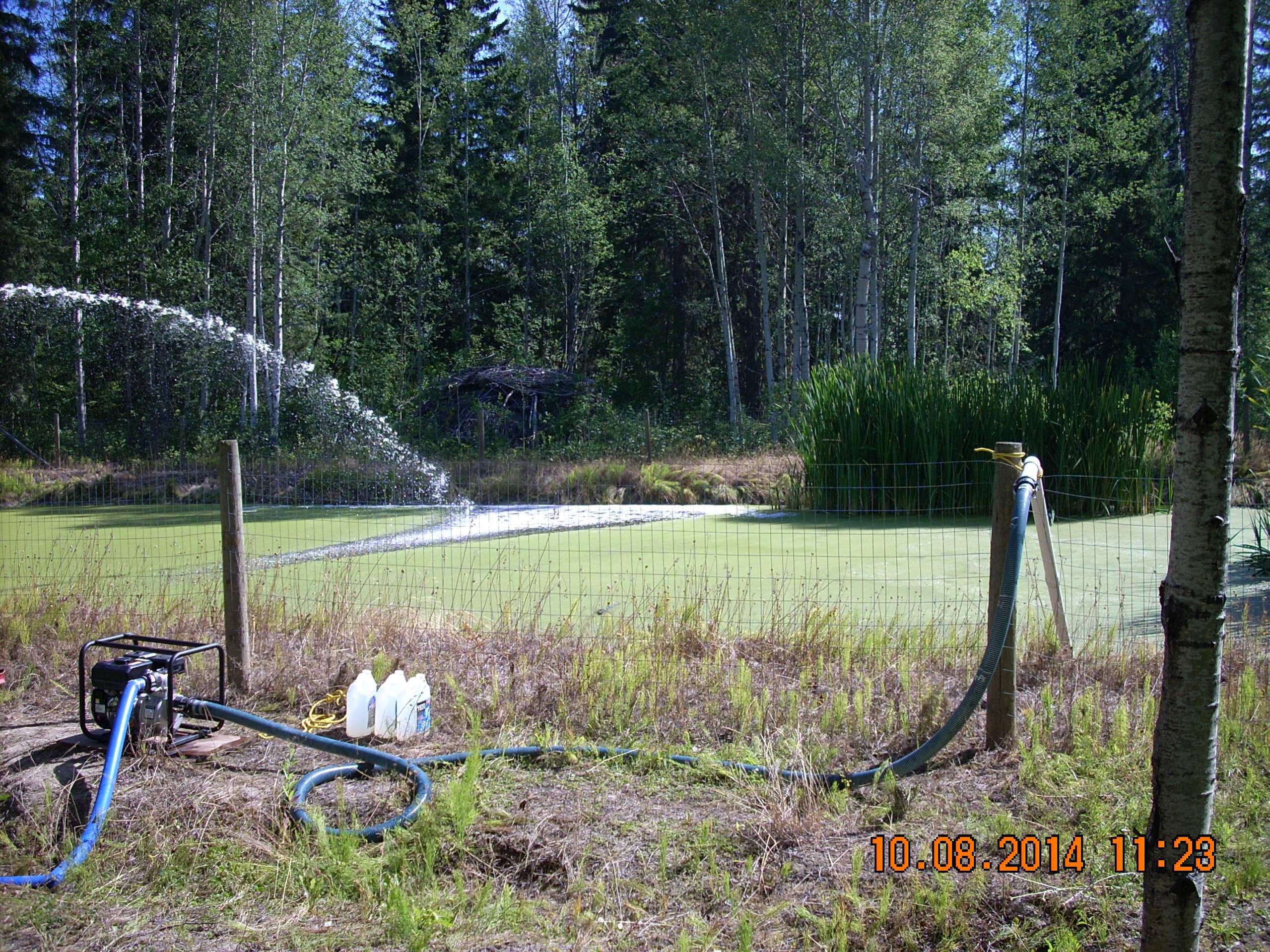

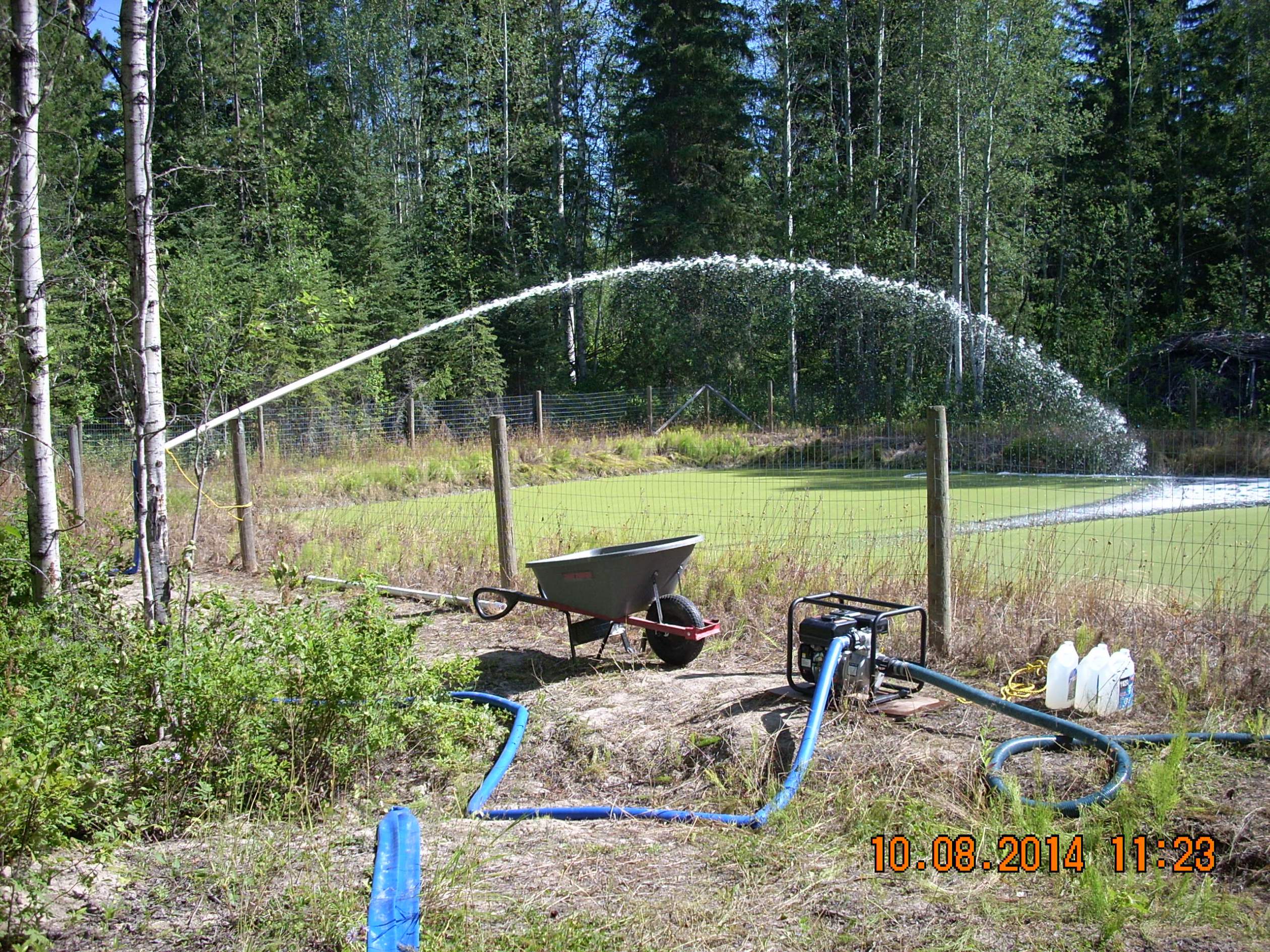

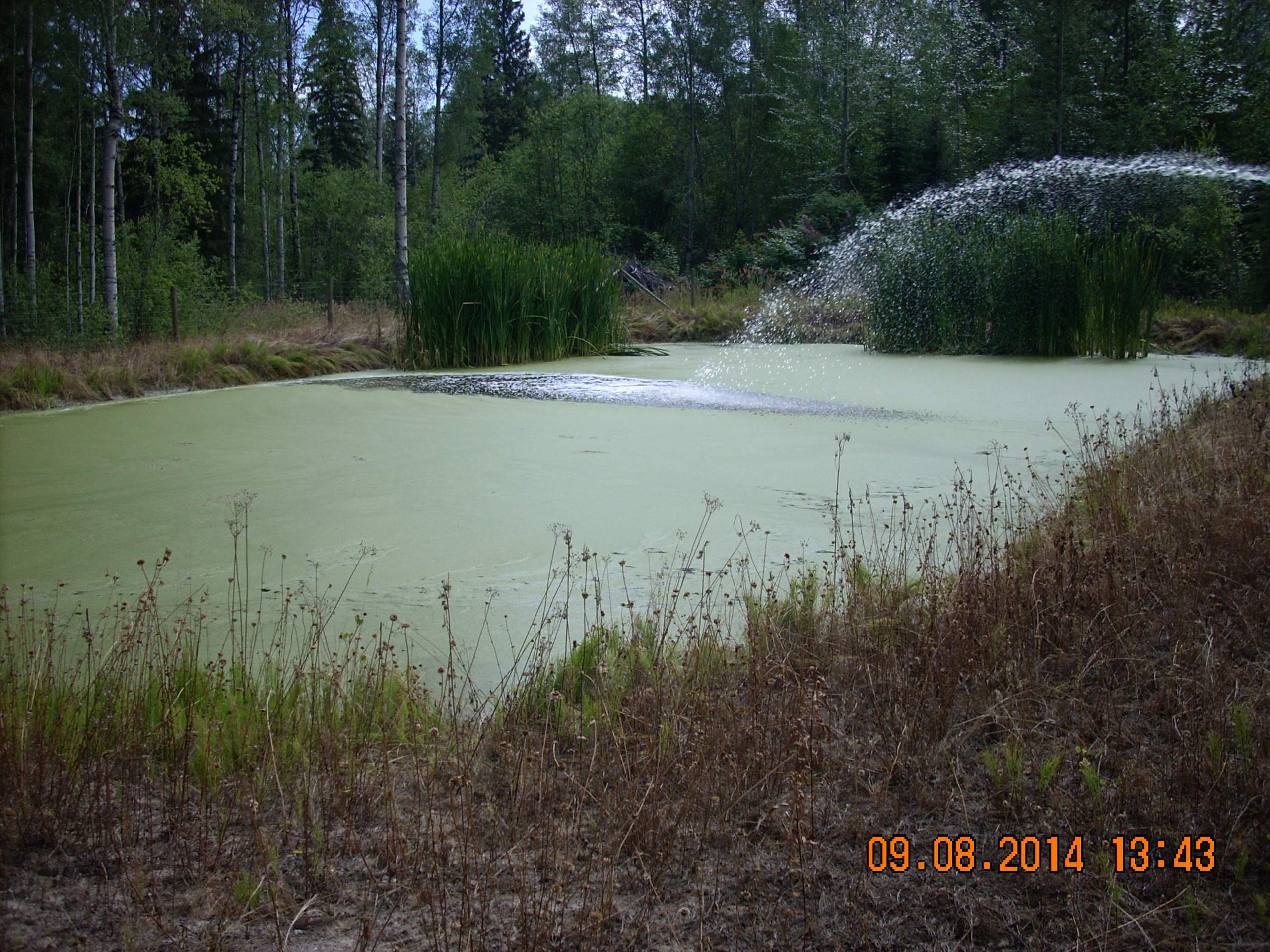

I can see some improvement in the algae today - it isn't so thick and it moves much easier now, leaving open spaces.
Today I noticed that the smell from the water has completely gone which I assume to be because of the spraying to add the oxygen to the water. So far all I have put in to the water is 4kg (8.8 lbs) of copper sulfate - still waiting on the bleach/chlorine as we only get into town once a week (40 miles away). I think that once I get the chlorine, it would be well worth using a syringe to spray it directly on to the water surface instead of putting it through the septic tank. I have a large syringe made out of 2" pvc which should do the trick and put the chlorine right where it needs to go.
It looks like I might have to circulate on a regular basis - I think the lagoon is probably a bit on the small side for the house size and it's performance is marginal because of the sizing. It is 80ft long x 48ft wide and has a working depth of either 4ft or 5ft - depending on how much is in it.

Just run the pump to circulate and aerate the water, let nature do the rest. You have some nice reads growing that will filter the water naturally and you risk killing them with the copper sulfate.
Bleach will kill all beneficial bacteria in your septic system, bad idea to add bleach to the system. A septic system is a living breathing system, do everything you can to keep it alive. Chemicals are likely to kill it and then you'll have a bigger problem.

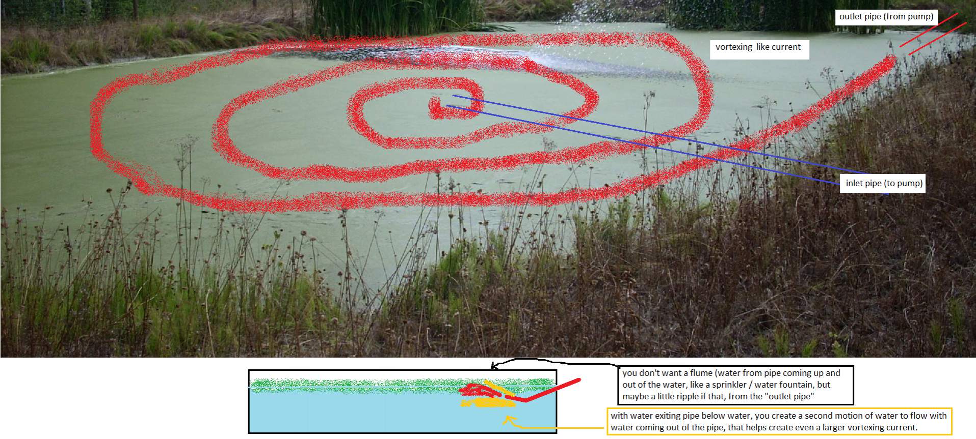

what ya doing will work, but your making a bigger mess than what you need to.
you want circulation! toss your inlet hose (into the middle) and then the outlet, place 1 to 2 feet under the water and pointed slightly upwards, so it shoots down the length of the lagoon / pond / lake. this will create a whirl pool / hurricane / vortexing like current. that causes everything to swirl. by placing the outlet of the pipe under the water and slightly pointing up. you get a second effect in that it will pull extra water/sewage/algae up to the surface and expose it to the air.
the above should give you the better overall aeration and circulation.
if you stay with spray bars or fountain like effect. your better off with very small little holes. smaller the better. but since your running a trash pump. that really doesn't have any sort of filtering. you end up hurting yourself needing larger holes that will not plug up. resulting in less air to water exchange. it doesn't matter how high ya send the water up into the air or causing it to splash. you will still be at a lower ratio of mixing water to air. vs above. its more about getting as much water as you can in contact with air. and water doesn't have to be shoot up into the air or be sprayed, or done in a fountain to achieve highest results. but rather simply circulating the water. so the entire mass of water circulates, causing dead zone areas to move and give it a chance to become right next to the surface of the lagoon. were you will get a lot more air/water exchanging happening.
majority of is noted above comes from www.koiphen.com and dealing with various fish/koi ponds. and simply learning how to make water currents work for you. vs against you. if you end up going with a diffuser setup. you may find some better choice diffusers through some of the dealers there. "epdm membrane diffusers" that are kinda self cleaning due to the nature of how they create air bubbles. along with air pump/s more likely rated for 24/7 running. double check on replacement diaphragm for air pumps, "devil in the details" can be rather expensive.

*cringes* killing algea = also killing off beneficial bacteria / parasites, and all the other little goodies of single cell stuff, that actually break down the waste, and help turn the waste into various stuff, that can be off gassed. your doing more harm than good. adding chemicals. and end up of cycle routine of buy more chemicals, and more chemicals and more and more.... and never getting out of the cycle. if you kill all the stuff that breaks the waste down... you will end up with a lagoon full of crud. and set everything back to point that you will have to wait for the good bacteria that you want, to break everything down to grow back. which may take 90 days or longer. this is a septic lagoon not a swimming pool. completely different.

My folks had a 40 x 40 lagoon for 25 years or so and the only thing they ever added was water during dry times.
As I mentioned before, I did use a seine to remove some duck weed like you have, but even then I don't know that it was necessary. It looked better though.
Usually an inspector would not like the cattails but probably wouldn't even care about the floating duck weed. Be careful with the chemicals. As others have said, it's a living entity that is breaking down your waste. Pretty much an all natural process that needs little attention.

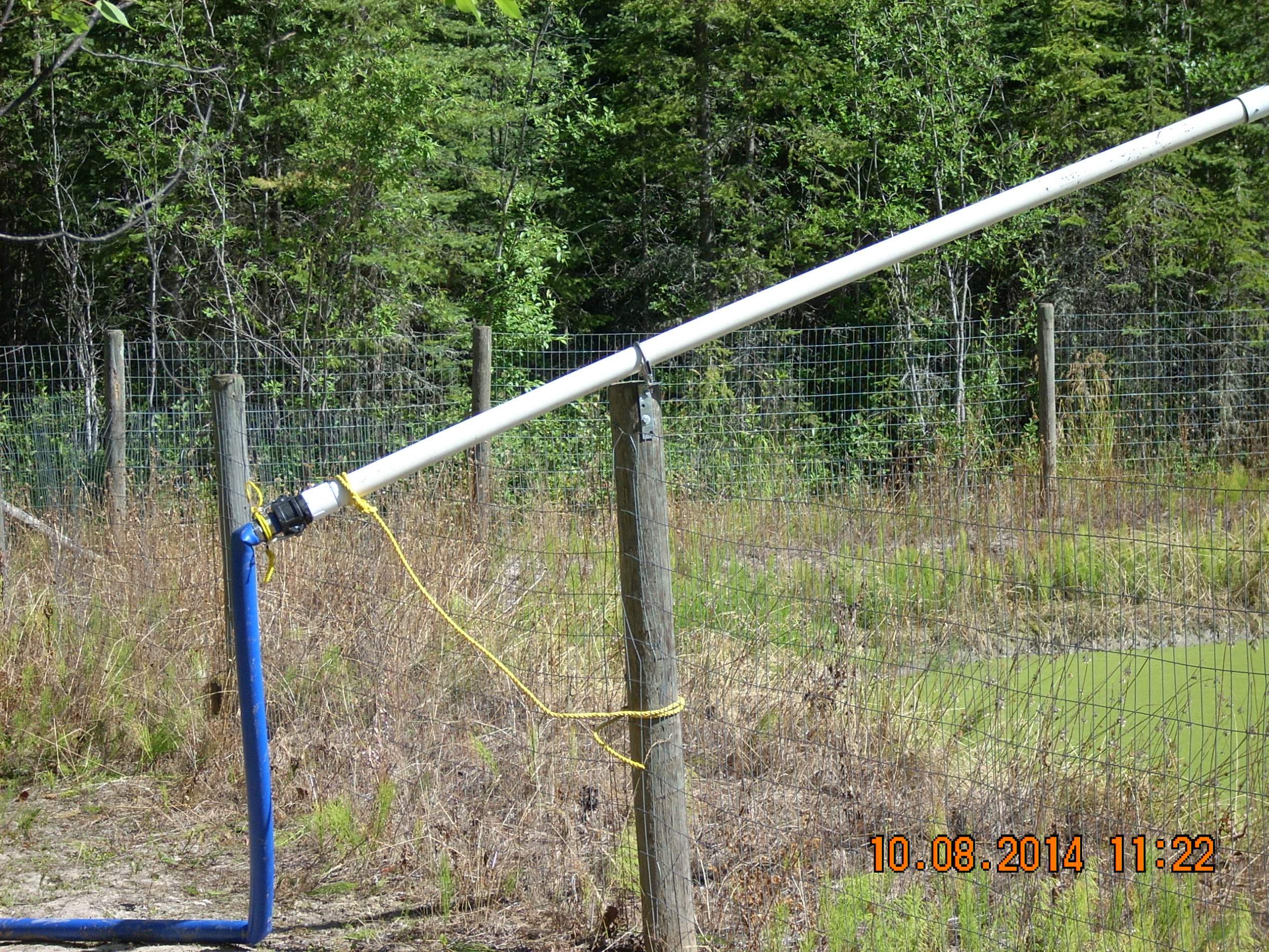

I was thinking of maybe putting a "T" at the end of the pipe and using 1" pipe with 1/4" holes or similar, to give a better spay area.
Actually, the suction is at one end of the lagoon and the discharge towards the other, but can be aimed to induce some surface movement. The lagoon isn't that big and I am reluctant to get too aggressive as I don't want to wash out the sides/banks.
