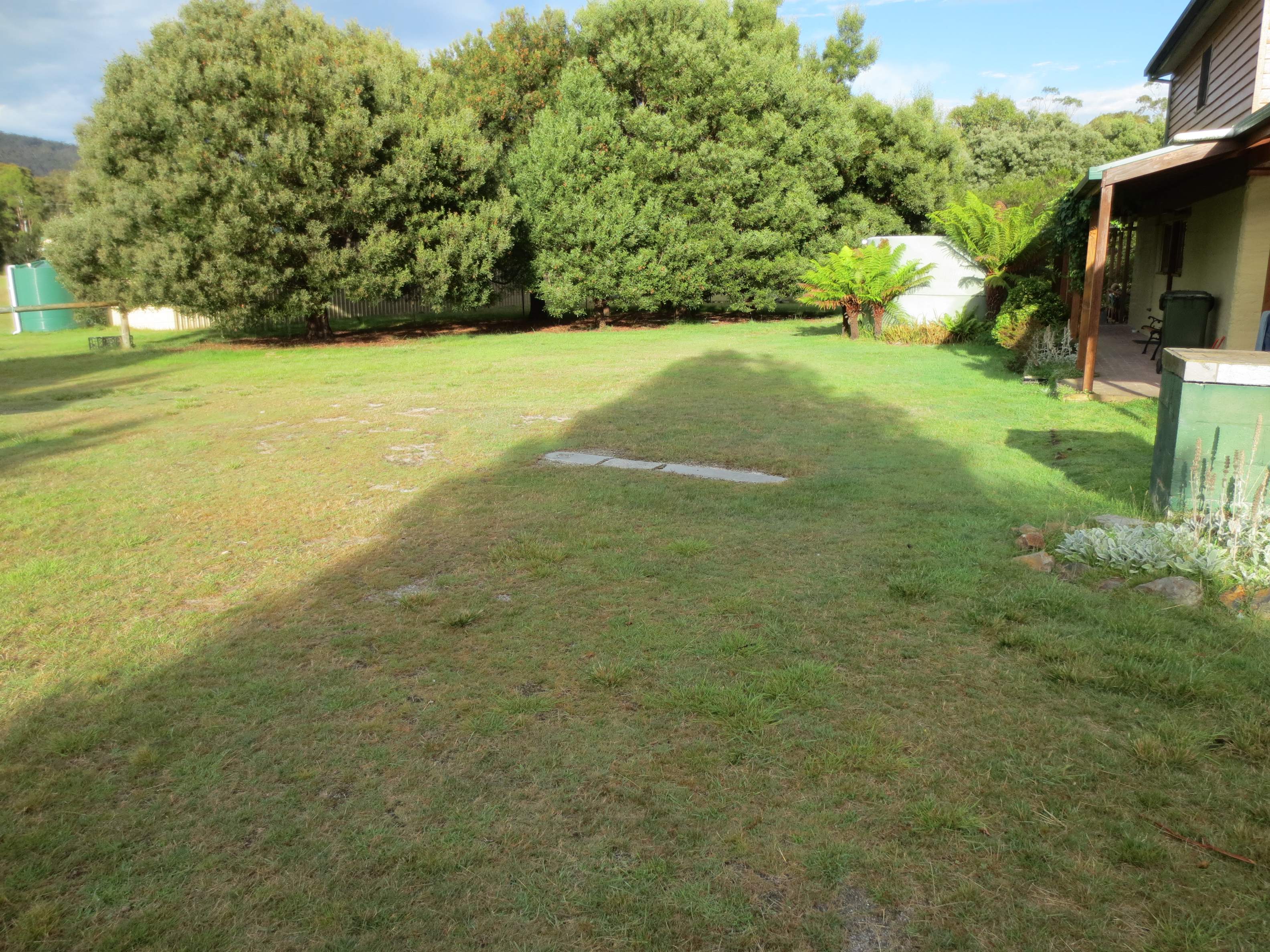

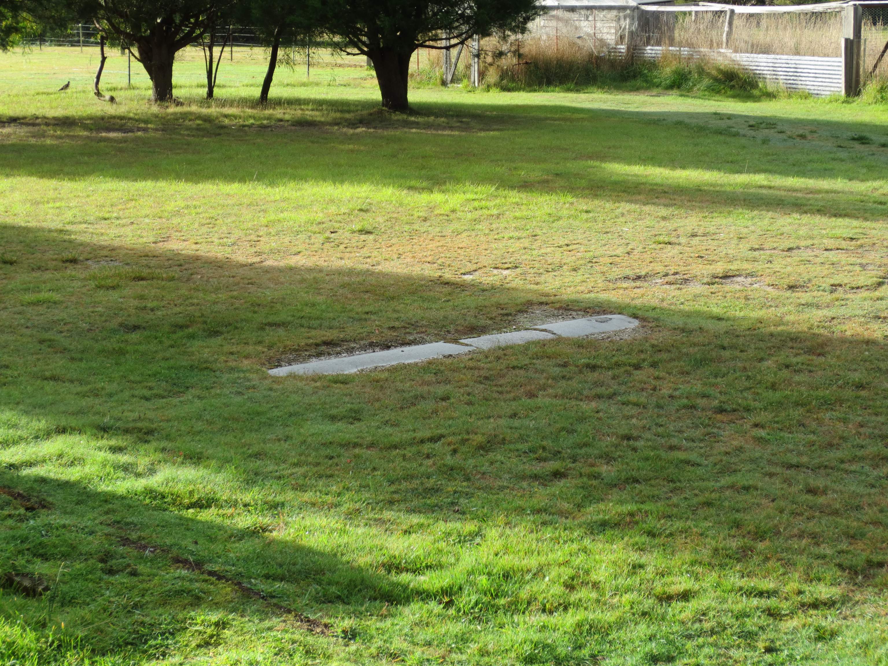

Mate, I haven't claimed anything; I stated a personal fact. No maybe about it.
I did state that I have a separate grey-water field, so the only thing that goes into my septic tank is human waste and bumwad.
