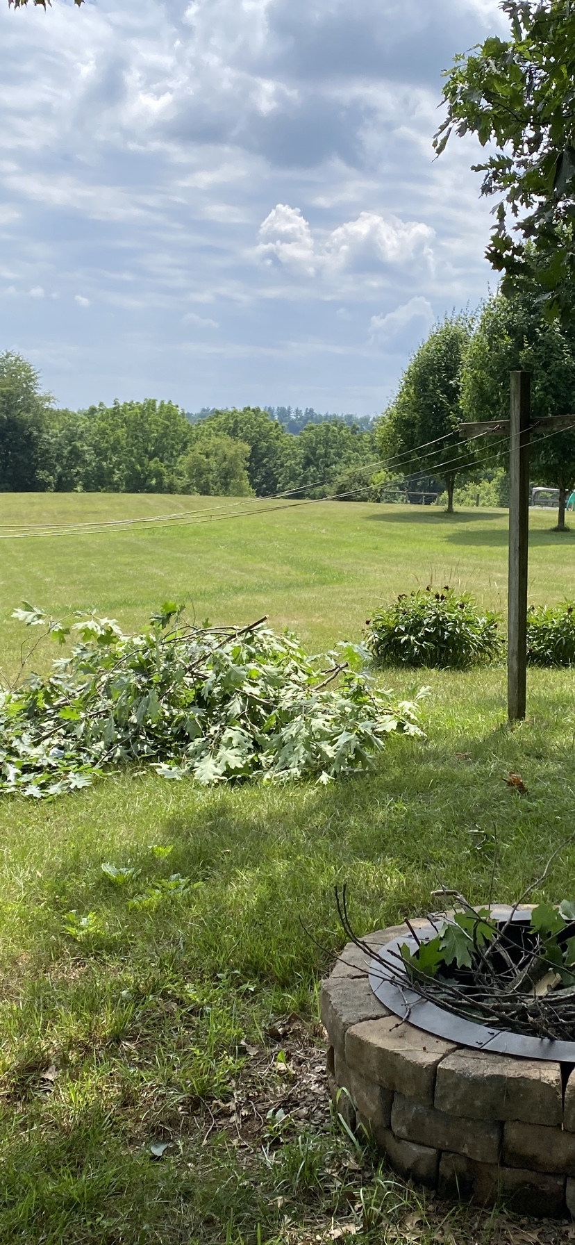

Tank located. Going to have it dug up due to it's depth and have a riser attached to it, and then pumped.
Per the layout the county had per the last "fix" in 1998, it's wrong. Even the guy that came out said it will be interesting exactly what's there when they dig it up.
I'll be here when they dig it up and take pics, and mark everything for reference.

My drain field was very obvious when we just had a dry spell. The tank riser is behind some flowers.
