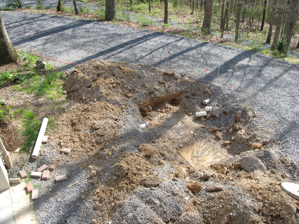

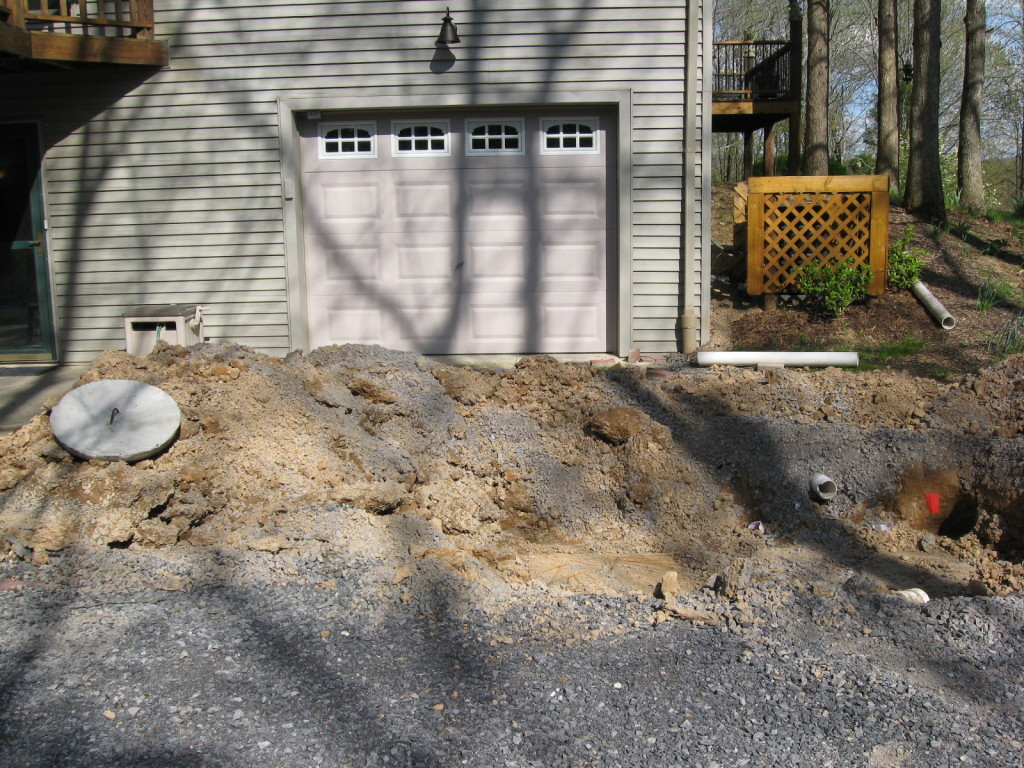

Well, after even more careful consideration, I and others determined it would be a dumb move to put in a new tank. The system works fine and I don't really have room to easily put in another tank.
I attached a picture of the tank exposed. On the left is the garage door. The guy that put that tank in that spot is a moron.
I still plan on putting a slab over it. I have a price of 1100 for mud work. The two sewer covers with flanges from East Jordan Iron Works are 450 each. This price sucks but I looked all day and couldn't find anything cheaper that can support the weight of vehicles.
I need to do this job unfortunately. I think I found the place that made the tank. I was snooping around today and noticed he didn't use wire in his tanks. I'll post a picture when the job is done.
Oh yeah. I'm going to put a one foot high 30" ring made of galvanized around the septic covers. They will hold back the dirt. On top of them I will use temporary wood shoring to hold up the sewer covers until they are dried into the slab. Once dry, I'll remove the wood.
I found both the environmental certificate and permit for the system. Neither of them matches what I have. They put down a system for 3 bedroom when I have a 5 bed/3 bath. I would have preferred larger system. The permit shows the tank behind the middle of the house with the filed where my driveway is now. The environmental certificate says everything is approximate as excavating and tree removal is ongoing. This is one time I wish the permits and such would have done their job. No wonder he was in a hurry to accept my offer and sell me the house. Shame on me for not knowing enough. This is my first (and hopefully last) septic system.

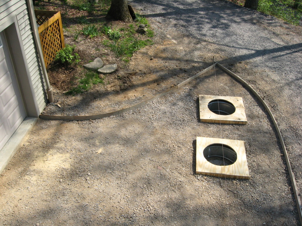

First picture shows the riser rings I put in. They are those bands that connect galvanized pipe. 12" high. The shop cut off the bolt flanges and then tacked them into 30" round circles for me. 20 bucks each.
Second picture is concrete forms in today. We built those plywood forms to place the sewer covers on top of. There will be 4" concrete on top of the two plywood boxes with the sewer covers.
