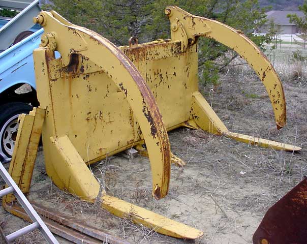

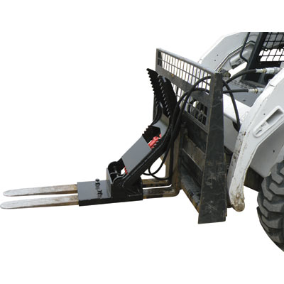

How about something like these to use with the forks to keep the logs in place?
