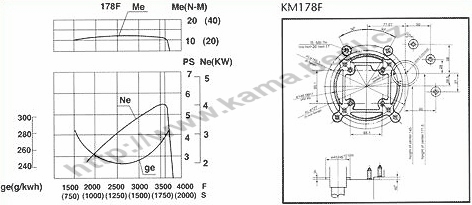

Are the Kipor/Kama engines good?
No first hand experience, but a bit of research shows that it is a Chinese company producing them, that used to produce some Honda generator sets as well, until Honda got upset that they were selling a copy of the generator for less. Often, as they say, you get what you pay for. That being said, I have a 4 stroke gas engine that is a chinese copy of a Honda on a vibratory plate compactor and so far no problems with it.
In Czechia and Slovakia I have also found companies selling the Kipor brand engines, so I would assume that getting spare parts if something breaks isn't going to be a problem.
Looking at the technical data however, the power output of the Kipor/Kama diesel motors is not close to the Lombardini ones that are paired with each model. I can't find a chart of the more powerful one, but looking at the 178F motor chart one also notes that you are pushed in to a region of motor operation that is not very efficient for fuel consumption when you go up to 3600 RPM:
