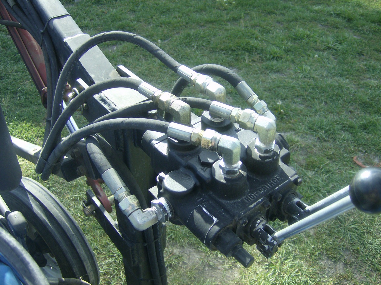

My current setup for my loader has two spools in one valve and the TPH down stream in the circuit from that. I can operate a single function of the loader at a time. I can't lift and curl at the same time. And, the TPH only works when neither of the spools on the loader control are activated. That tells me that I have a series valve with the two spools that is not a power beyond valve. Is that right?
Is power beyond needed for every multiple valve system or just those systems that require more than one valve to be operated at the same time?

I would guess that your loader valve does have a Power Beyond output. That is the high pressure line that feeds your 3PH. How many hoses does it have, 6 or 7? I would guess 7, 3 large and 4 small to the cylinders. The 3 large would be HP inlet from pump, HP PB outlet and LP return. You see when you raise a heavy impliment on the 3PH, all the lines and fittings between the pump HP output and 3PH cylinder must be able to endure full system pressure. PB is this high pressure passage thru the valve. So I would guess that your system goes like this.
1. Pump
2. Loader control Valve with PB line out to 3PH and LP return line to reservoir.
3. 3PH control valve
If it only has 6 hoses, do you have a picture of it?

I'm pretty sure that it has just 6. At least it just has one line in and one line out.
I'll get some pictures tonight after work and post.

I would be interested in seeing a picture. There are some valves configured with return and HP outflow together and rated for full system pressure. But most valve designs have the return galleries from the cylinders out near the ends of the spools and contain this low return pressure with "O" rings. As such, the return pressure is usually limited to a certain level. For instance Prince on their monoblock valves limits the backpressure on the return port to 500PSI. Now if this return port feeds on to another valve, loading up that valve could force oil past the "O" rings of the first valve and cause leaks at the ends of the spools.
