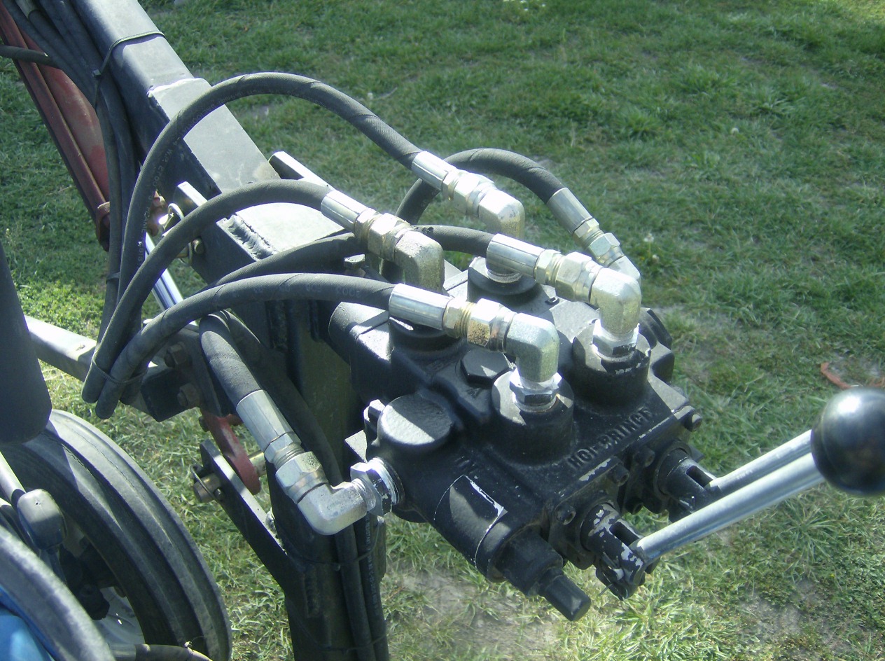

Here's the pic of the loader valve.
Also, I couldn't resist. I started up the tractor just to try and feather the valves. Low and behold it's true. If I hold them both just right, I can get the loader to lift and curl at the same time.

Well you have one of Rays loaders with a prince 5200 series monoblock valve and it is plummed wrong... Your outlet line on the right side of the valve as pictured is plummed into the return port and runs right along into the rest of the system(steering and 3PH?). That port is rated for no more than 500 PSI of back pressure. How do I know this? I had one exactly like it on my Jinma, and it was plummed like yours is with the return port feeding the rest of the system. If you start bouncing around a heavy impliment on the 3PH, or ripping out rootwads with a middlebuster, you will start applying full system pressure to that return line and the #213 "O" rings at the spool ends will let go and start dumping hydraulic fluid on your right boot.
My 3PH control valve safety was also set wrong and was relieving at naearly 3000 PSI which didn't help matters any(3PH lifted like mad though:)).
To plumb this properly, you need to get the PB sleeve for this valve. surplus center has them for around $12. Surplus Center Item Detail and install it where the large hex head plug is now, just to the rear of where the outlet line is now attached. Then move the outlet line that feeds the rest of the tractor hydraulics to this new high pressure rated PB port. Then add a new return line to the forward port and run it to a LP return("T"d in down stream from the power steering if so equiped) back to the reservoir.
If you don't lift real heavy impliments with the 3PH, and don't want to mess with the plumbing changes, the "O" rings will probably last quite a while. They are only about $0.15 each and they take about a half hour to change out all of them on a 2 spool valve when they go.
I changed from a 2 spool valve to a 3 spool a few months ago, but did not yet make this change. I expect to go thru a set of "O" rings when I get the 5' brushhog back on the 3PH this fall. If I have some time this winter I will be making mine right.

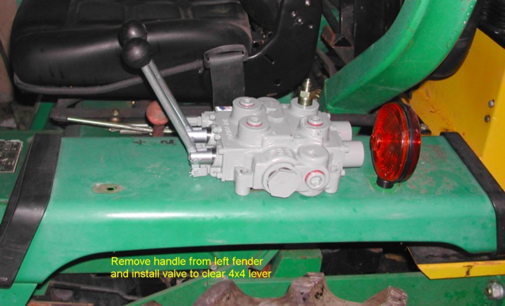

This is the Prince RD5200 being installed on a JD955 left fender
(no room on the right). The power beyond sleeve is installed
under the large cap in the middle. Both were purchased from
Surplus Center, but I have purchased numerous Prince valves
from Prince Direct when they were operating. A very good
valve, if a little larger than needed for this application.
IPLAYFARMER: you don't need 400+KB-sized pix when you post.
Those of us who do not have broadband internet access would
require minutes to see these excessively-large pix. 50KB-150KB
is plenty big enough.

Yep, that is a good pic of where the PB sleeve should go. Here is a link to the prince spec sheet with one of those valves configured for PB. Just imagine the single spool valve in the diagram on the second page of the spec sheet is your 3PH control valve downstream of the loader valve.
http://www.princehyd.com/Portals/0/products/valves/RD5000InstS.pdf
