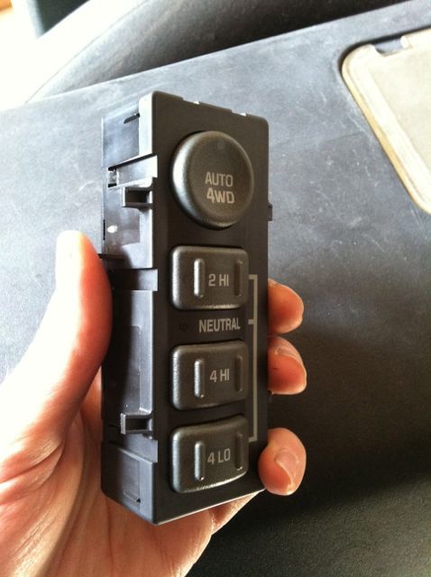

I have a 2001 GMC Sierra half ton pick up. The "service 4WD" light goes on occasionally, and at the same time the ABS light went on. I took it to the garage that I've used for 13 years, with excellent results in the past. They said nothing about the 4 WD came up on the computer, but both front bearings were bad, and that's what was causing the ABS light. They thought the bearings might also be causing the "service 4WD" light, as well. They replaced the bearings a week ago, and all was well, until today, the "service 4WD" light came on again for about 1/2 hour and then went out. I should add that throughout this, the 4WD works flawlessly. Has anyone else had a similar problem? Does anyone have any idea what is going on with my truck?

I've read on some other forums about the same issue. Some have said that if the electrical connectors on the transfer case and actuator get loose or corroded, it will throw the service 4WD code. Easy and cheap to check them out. I pulled mine, checked them and added some dielectric grease just to safe the last I was under the truck.
Others have said that if fluid levels get low enough in the transfer case or the front differential that it doesn't splash up on the sensors, it does the same thing. Another cheap and easy check, unless you have the 4WD controls on the dash, then you need the expensive Auto Trak II fluid for the transfer case, but if it is low, then a $10 bottle of fluid is still a cheap fix.
I'd check these first then if the problem sticks around, replace the dash switch first, then the actuator.
   / Service 4WD Light #5

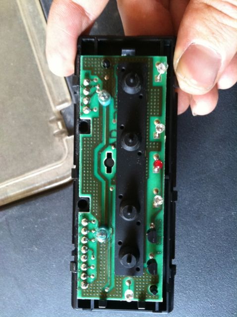

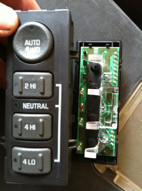

The first thing I would do is pop out the 4WD switch and re-solder the connections inside. there are about 12 that are common to crack. Takes about 15 minutes and costs you nothing.

Pull your switch out and inspect the solder joints. My cousin's truck was not shifting into 4-Low or 4-high and re-soldering the switch fixed it.
   / Service 4WD Light #9
Replaced the switch in my '99 Sierra about 10 years ago for that problem. For $60, I just replaced it.
