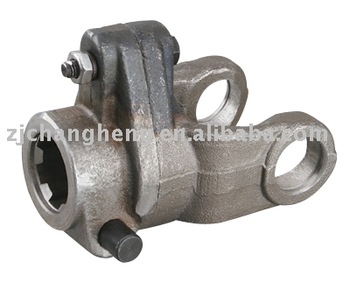

Shear pins are a pita to replace when you don’t want to but over all they sure seem to be less main required from my POV.
   / Service Your PTO Clutch #7
Shear pins are a pain to replace because the implement manufacturers in the US insist in this absolute crap of a design for the shear pin that leaves the broken piece stuck in the input shaft.
There is this style of shear pin showed on the picture below that an absolute breeze to run. Easy to see if it broke, easy to replace without pulling anything apart and somewhat cheaper to run due to the use of smaller bolts (M8 or 5/16), although this is probably minor. One can simply pull both broken pieces by hand and slap a new one in.
   / Service Your PTO Clutch #8
That's the exact type on the end of my PTO shaft - ptsg. Every year I remove the shear bolt - rotate the two parts - spray a good grade of lube on the exposed surfaces and make sure it seeps down into the body of the fixture. Probably unnecessary but it's a part of my routine maintenance.
It's my PTO shaft for my Wally BX62S. I've sheared two pins/bolts. Both times chipping old, dry, rock hard apple wood. So ......I know it works.
   / Service Your PTO Clutch #9
Mine have a grease fitting in the middle to lube the parts that rotate when the shear pin breaks, so I don't really bother to take it apart. Just grease it and let it run but it's definitely a good practice to go over it.
I think it's a good alternative for the people that don't use an implement with a PTO clutch enough during the year to prevent it from rusting and locking up. Or the ones that kind of neglect maintenance on implements.
