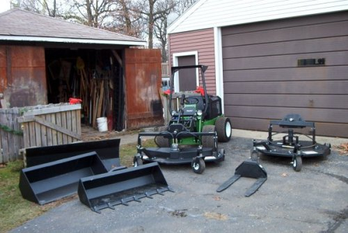

I am also a fan of the toothbar.
I have two buckets. One is 48" wide and has a straight blade across the front. The other is 42" wide with 7 teeth. The flat blade is good for very loose material like small gravel, sand, soil, scraping off a flat surface like concrete or a trailer deck, or acting like a power wheelbarrow. It's also good for back-dragging and leveling. But it has a lot of trouble pushing into hard materials, like a lawn, large pile of rocks, undisturbed soil. The tooth bar works a lot better for that.
Think about it. If your tractor can push with X amount of force it's spread across the entire 48" of blade. Now concentrate that same force on 7 small points, let's say an inch across each. 48/7 is about 7. You're gonna get all that pushing force concentrated on 7" total VS 48" total.
Make sense?
Here's a picture of the two buckets. Click to enlarge.
