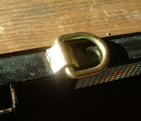

I wanted to add more D-rings to my trailer so it would be easier to chain down my equipment. I used zinc plated rings so they wouldn't rust as quickly. I first ground off the paint and zinc where I was going to weld.

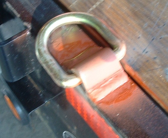

Re: Set of D\'s
Next I used my Miller 210 MIG to weld 4 rings on.
   / Set of D's
Re: Set of D\'s
Then a shot some primer on.

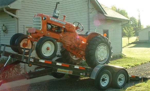

Re: Set of D\'s
Now it's time to load the old Allis and test them.

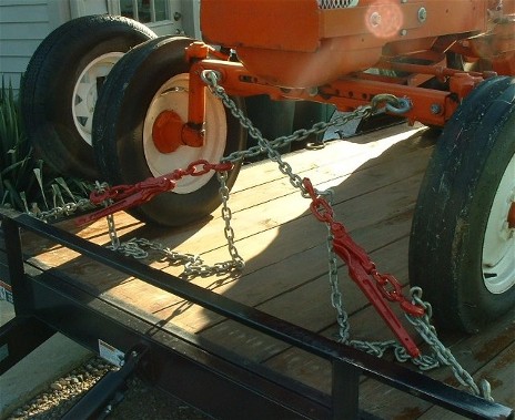

Re: Set of D\'s
Time to chain it up with Grade 70 transport chain. After I set the binders I will wire the handles so they can't pop open.

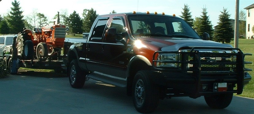

Re: Set of D\'s
Now we are ready to roll!
   / Set of D's #8
Re: Set of D\'s
What will the test be like?
Do you think the rings will hold the 'old' Allis on the trailer?
I don't know, just asking 'aloud'.
   / Set of D's
#9
Re: Set of D\'s
Actually the Allis only weighs about 4,000 lbs. Each ring is rated at 11,000 lbs so I don't think that strength will be an issue. I drove to a tractor show about 60 miles round trip down a bumpy road with no issues that day.
