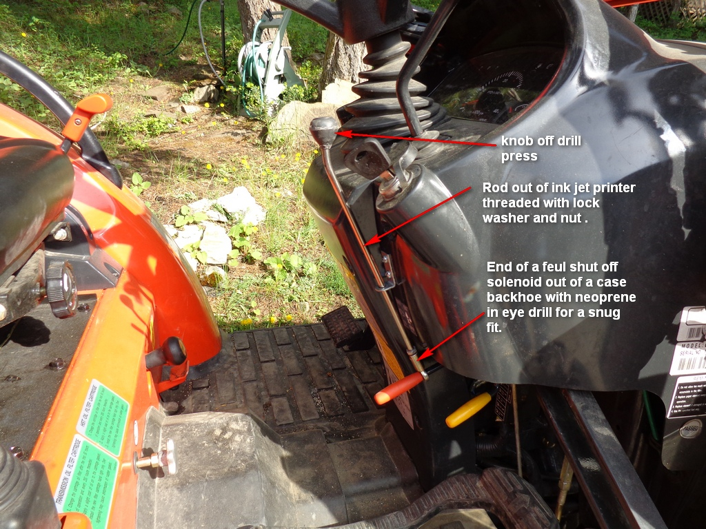

Living on a mt. side and needing to use the break every time I stopped I came up with this idea. It worked perfectly for 6 yrs. on my CK27 and now I've done the same mod on my 2610 Kioti .

I've never owned a tractor with a parking brake, well I guess the old Massey 35 did but never used them. I guess that's a hydro thing. Looks like that'll get the job done.

I guess I don’t understand the need for a custom parking brake lever. My Kubota has a lever that is easily engaged by stepping on the brakes then engaging the lever. My previous JD was the same. Does Kioti not have a way to easily engage the parking brake?

My Kioti, ck3510 HST, has a lever next to the brake pedal. Step on brake with right foot and push lever forward with left foot. To release the parking brake just push down on brake pedal until the lever releases.

My LS came from the factory with a very nice easy to use parking brake lever, it’s standard equipment , sometimes I forget to release the parking brake but that quickly activates a warning beeper and a flashing red light on the dashboard so I’ve never driven more than a foot or two with the parking brake set.

What a great idea! Thanks for sharing this.
I have a bad habit of tapping to foot brake and unlocking it without realizing it. This would make it much more obvious as well as easier to operate.

I had the same idea and never implemented it. I usually Just ground the FEL and or counterweight/implement (usually BH, rear blade or BB.

My MF GC1715 has brake lock lever right up next to instrument panel, step on brake petal, and mover lever down with left hand.... BAM... Brakes locked..... Same with my JD LS120 riding mower....
