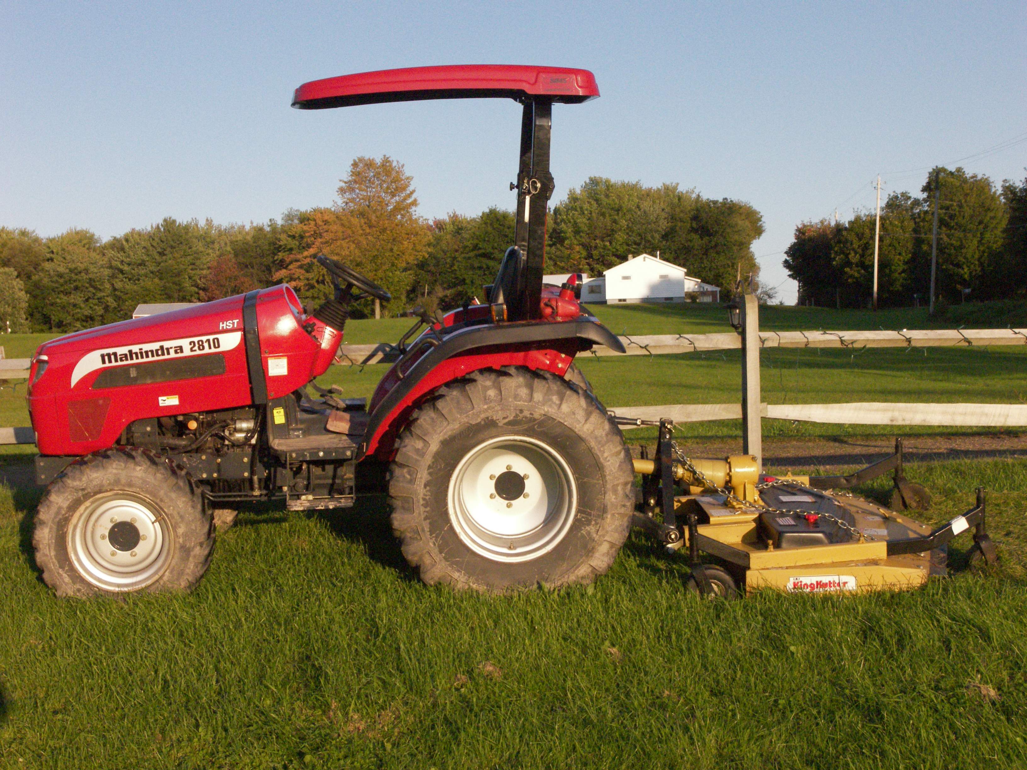

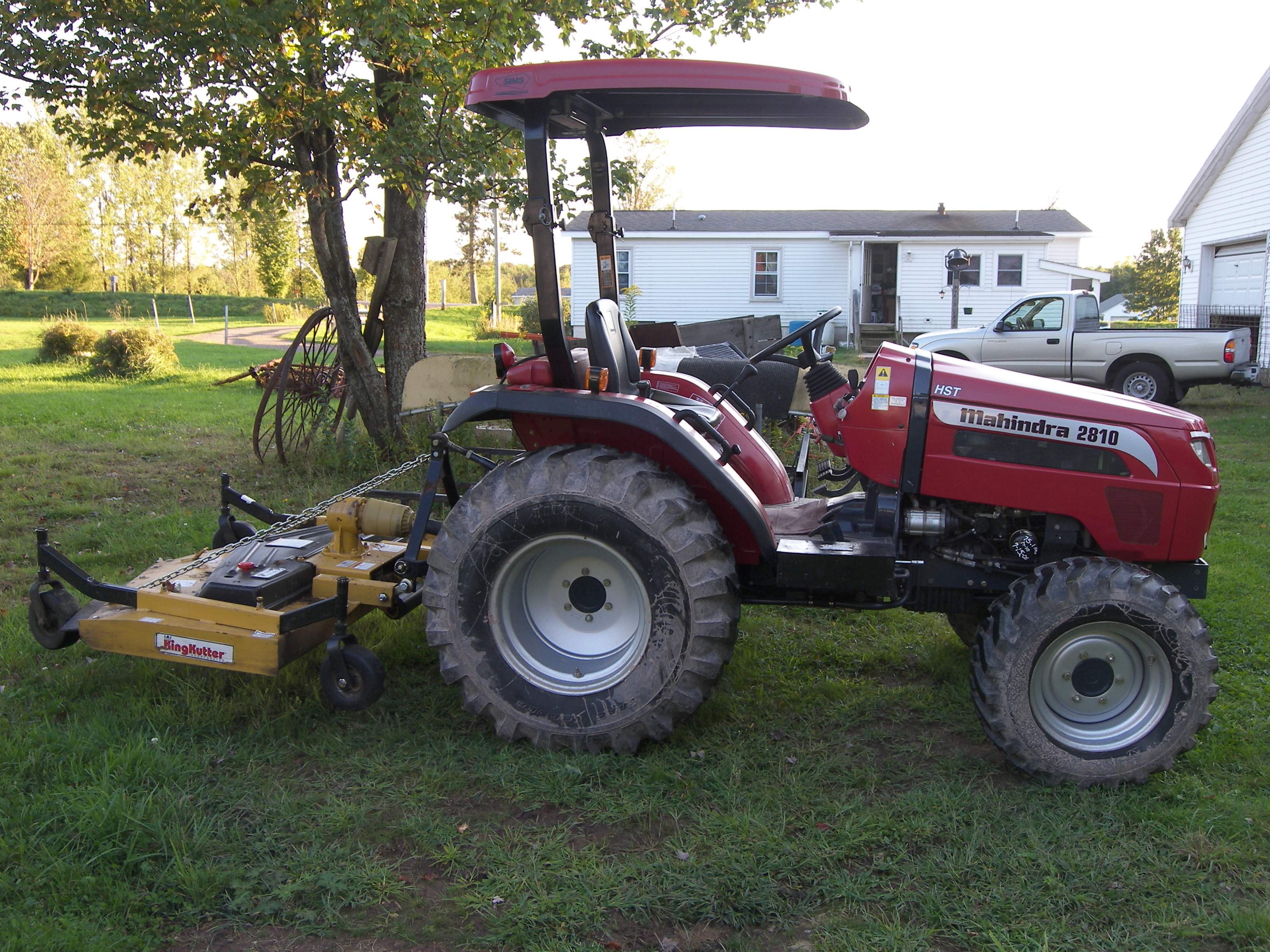

I don't know what kind of finish mower you have but here's what i have done to my mowers. I have King kutters and mow large parcels of land which is all hilly and a bit rough. I didn't like the rear frame work the mowers had so i removed it and put 5/16" chain from each of the rear corners to the top link. My mowers follow the ground much better, raise more evenly and ride much better in transport. I dont Mess with the top link hardly at all. I have a Hydralic Top Link on my Kioti but not on the Mahindra. The Mahindra is the primary mowing tractor. I set the top link and very seldom touch it again.
My mower has a "flex hitch" on it and with the rear chain lift and "flex hitch" it never scallops the ground.
Personally, i will never buy a mower without the "Flex Hitch" system.
BTW there is 8000 acres of mowing on that mower now . . . John

My mower is a small 4' version of the one picture. Maker and age unknown.
If I used chain, either as in pictures, or to replace the top link, I think I would still need to adjust the tension to get the droop I want and still be able to pick the mower up.
