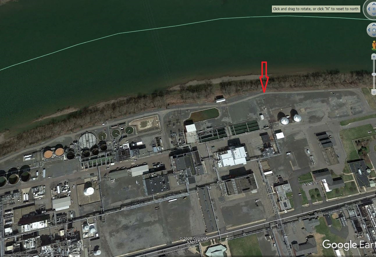

Several years ago we did underground work at a facility next to a river. Since it was over 20' deep and yards away from the river, a tremendous amount of planning and training was done before scooping any dirt. The installation was under the road shown by the red arrow. I saw a safety video of a guy dying in an excavation less than 4' deep on a project at an existing hospital. Medical people on site couldn't save him. OSHA requires a "Competent Person" for any excavating work, and they'd best be truly competent. We're not arguing about drilling a 1/4" hole in a ROPS here. This is serious stuff.

I install water main pipe I know how dangerous it is......Very serious stuff..
