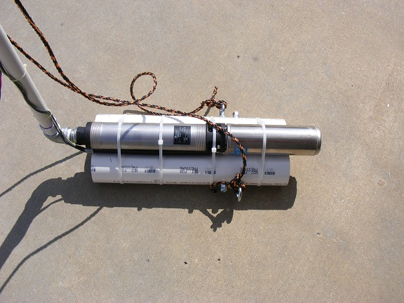

At that depth use a Hallmark, 1HP, 33 GPM pump. They are inexpensive and seem to be lasting pretty well. You can even lay it on its side if the water level is less than 5' or so and can't stand it up.

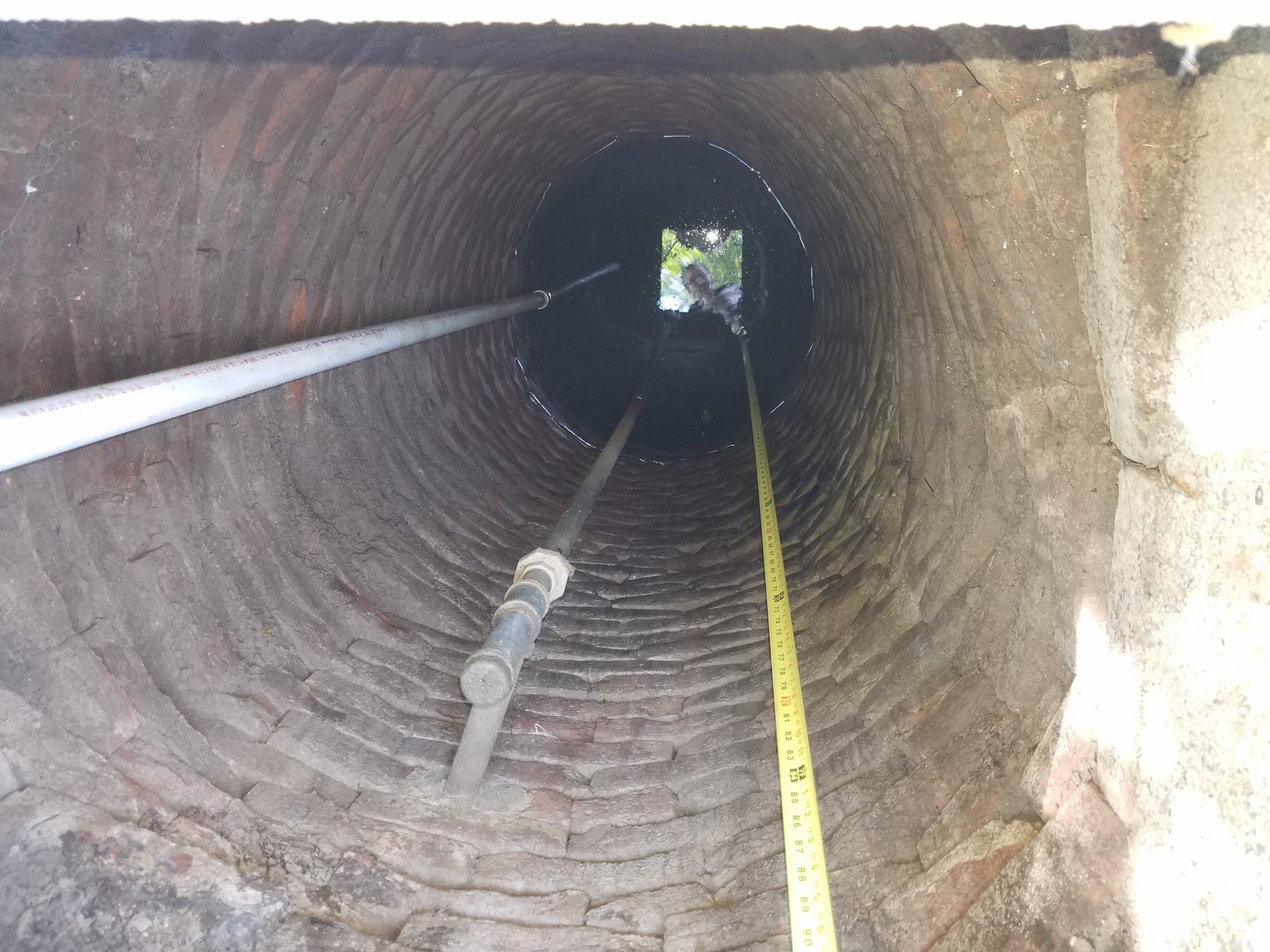

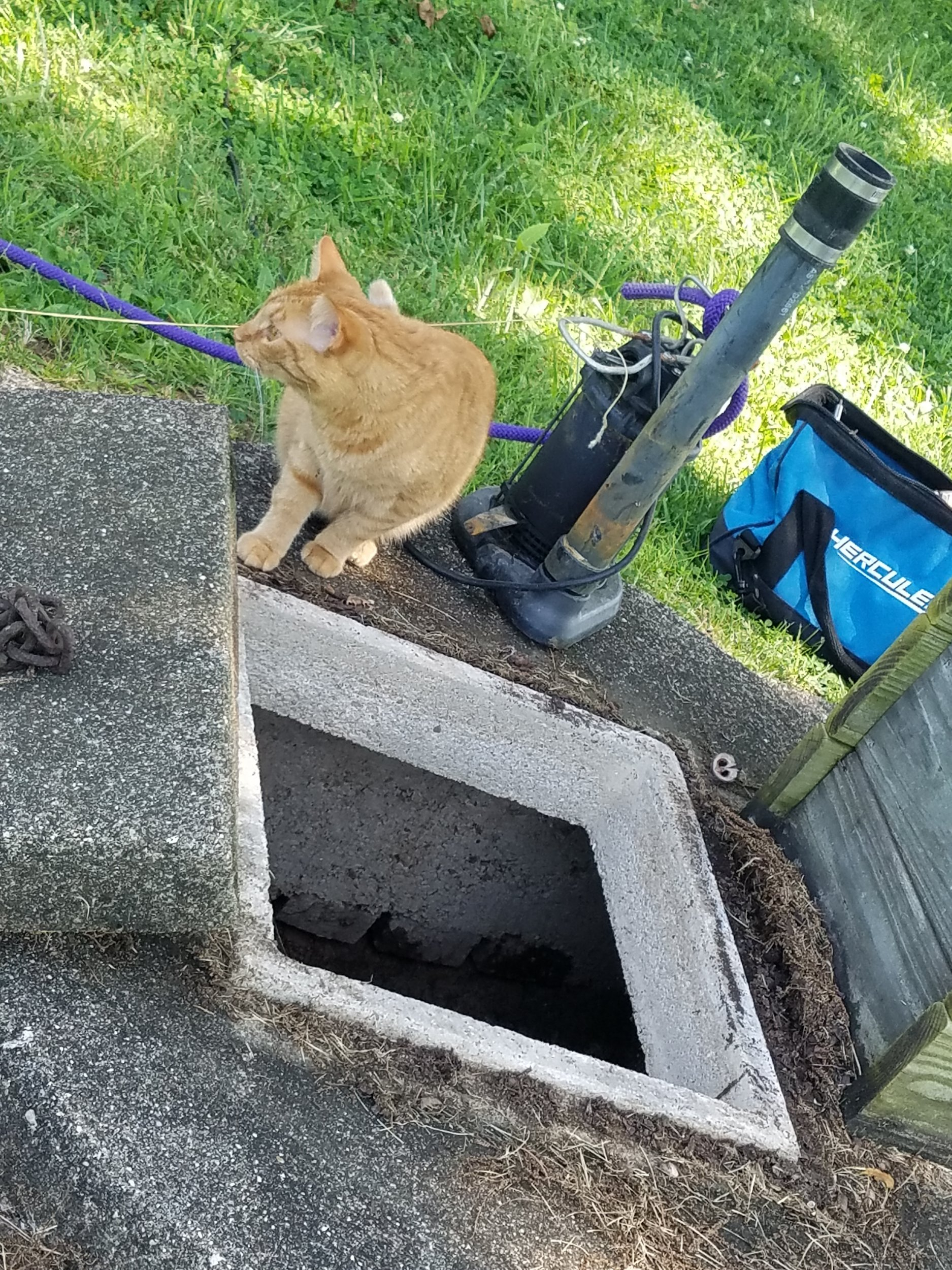

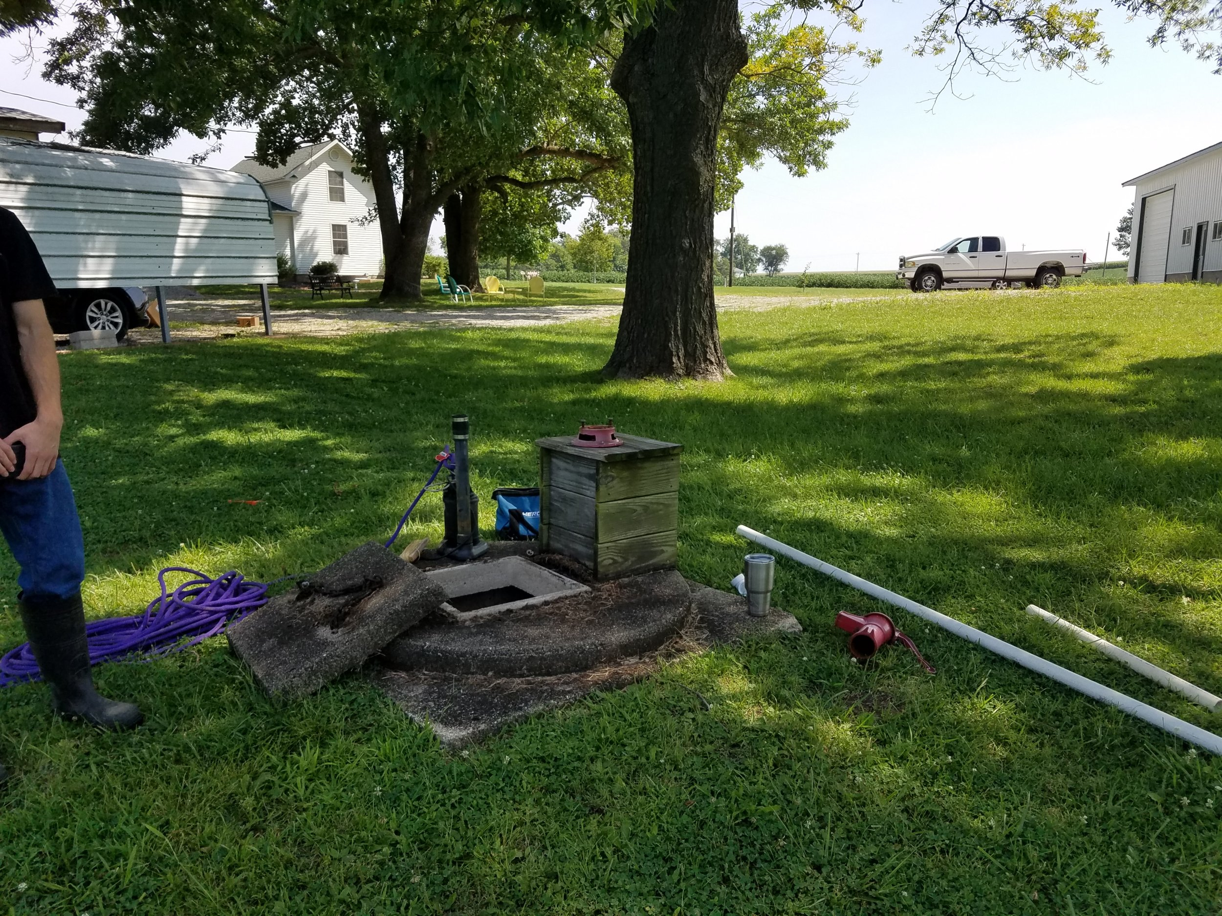

I found my 25 year old sump pump (saved from home renovation) in the shed and gave it a test in a bucket of water. It worked well in that bucket, so I devised a plan to lower the pump into the well while attaching successive lengths of PVC pipe. With the help of my family and the cat, we got the pump into the water and turned it on. Worked well for a bit, then water started squirting out the bottom of the pump (it appeared from my view). Pulled it out and determined there was a screw missing from the bottom plate of the pump and discovered a hole in the first length of plastic pipe that was resident on the pump when I found it. I found a screw for the bottom plate of the pup and replaced that short piece of pipe. Heading out shortly to give it another whirl.
Also, memory is a funny thing. When I installed the handpump about 8 years ago, I SWORE the depth to the bottom was 25 feet. As you can see in the photos, the depth is only 23 feet to the bottom of the concrete cap. That time 8 years ago may have been a dry summer, as there is clearly more than 4 feet of water in the well! Or perhaps this number was based on my impeccable memory of that time too? Today it is only about 8 feet from the concrete cap to the water's surface. That gives me about 15 feet of depth in that well! This getting older thing is quite humbling.
Based on the amount of water in the well, a submersible may just be the ticket. I'll get it pumped out today and observe the recovery time. Also, will get that new water tested ASAP. Do I need a pressure tank for a submersible pump?
Some photos are attached to illustrate what I'm doing.
Just searched for "hole in sump pump pipe" and found a thing called a weep hole. Sounds like that I need to leave that pipe with hole on the pump?!
That seems like an excellent idea!

My trusty sump pump pooped out before we hit the bottom of the well, but we did get the water down to 15 feet, 4 inches. We started with the surface of the water at 8 feet, three inches. Now let me see, 4 foot in diameter with a change of 7 feet, one inch gives me 658 gallons in about 2 hours.
Gonna eat dinner and recheck the numbers. Maybe I need to remeasure the diameter of the well. That one thing I didn't take a photo of my tape measure on.
/ Shallow well pump selection #17
Wait, water level that high before drawing down? Forget anything I said. o_O (.. and after water test anyway) See post #9. (y)
#18
Wait, I remeasured my diameter of the well. it is only 31 inches in diameter, not 48! Imagine the fish I've told stories about? Okay, that means a recovery rate of 274 gallons in about 2 hours. Is that a good number?

2.3 GPM.......it ain't great, but it is what you have got, and depending on the cu.ft. of stored water in the well it may work for you.
