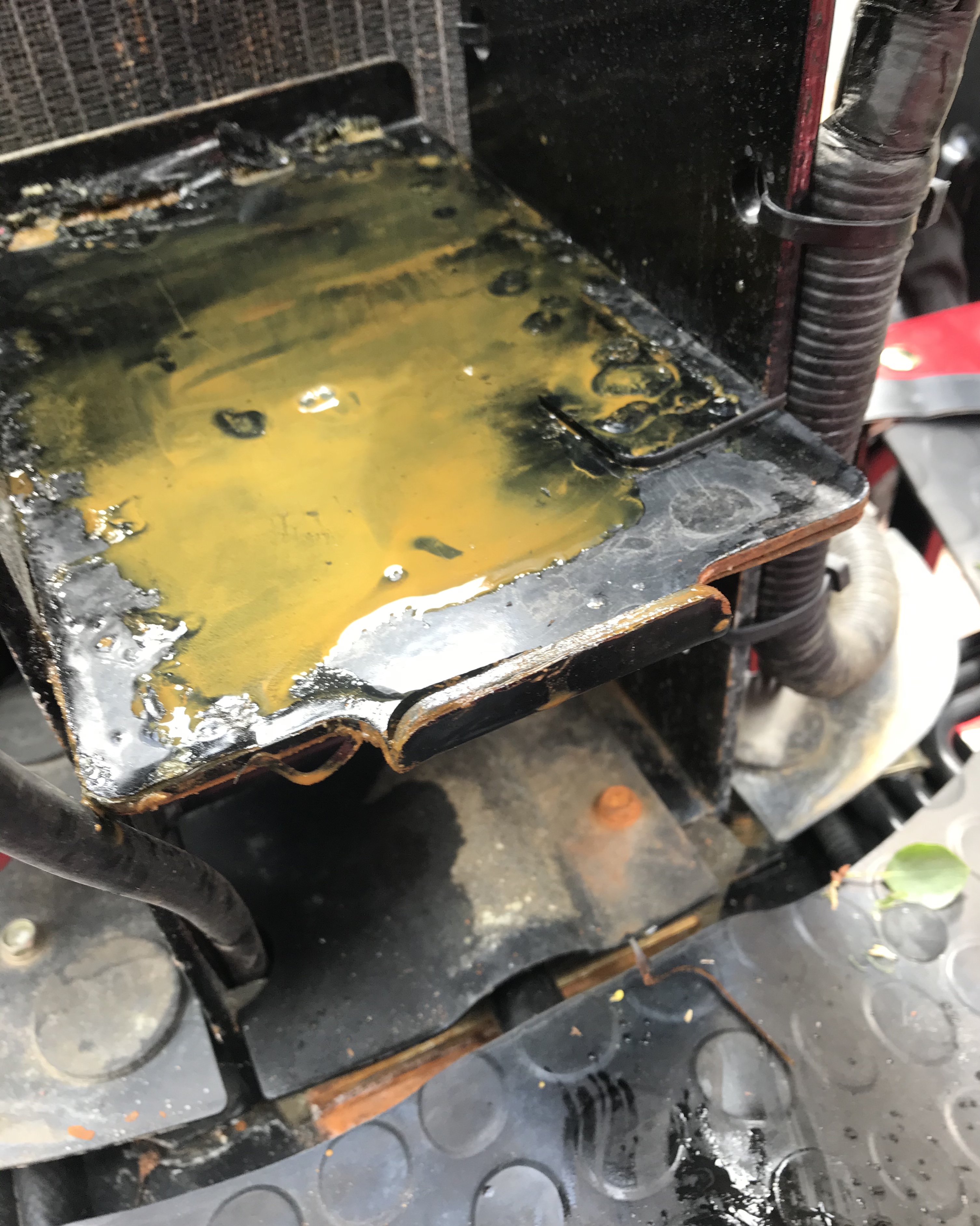

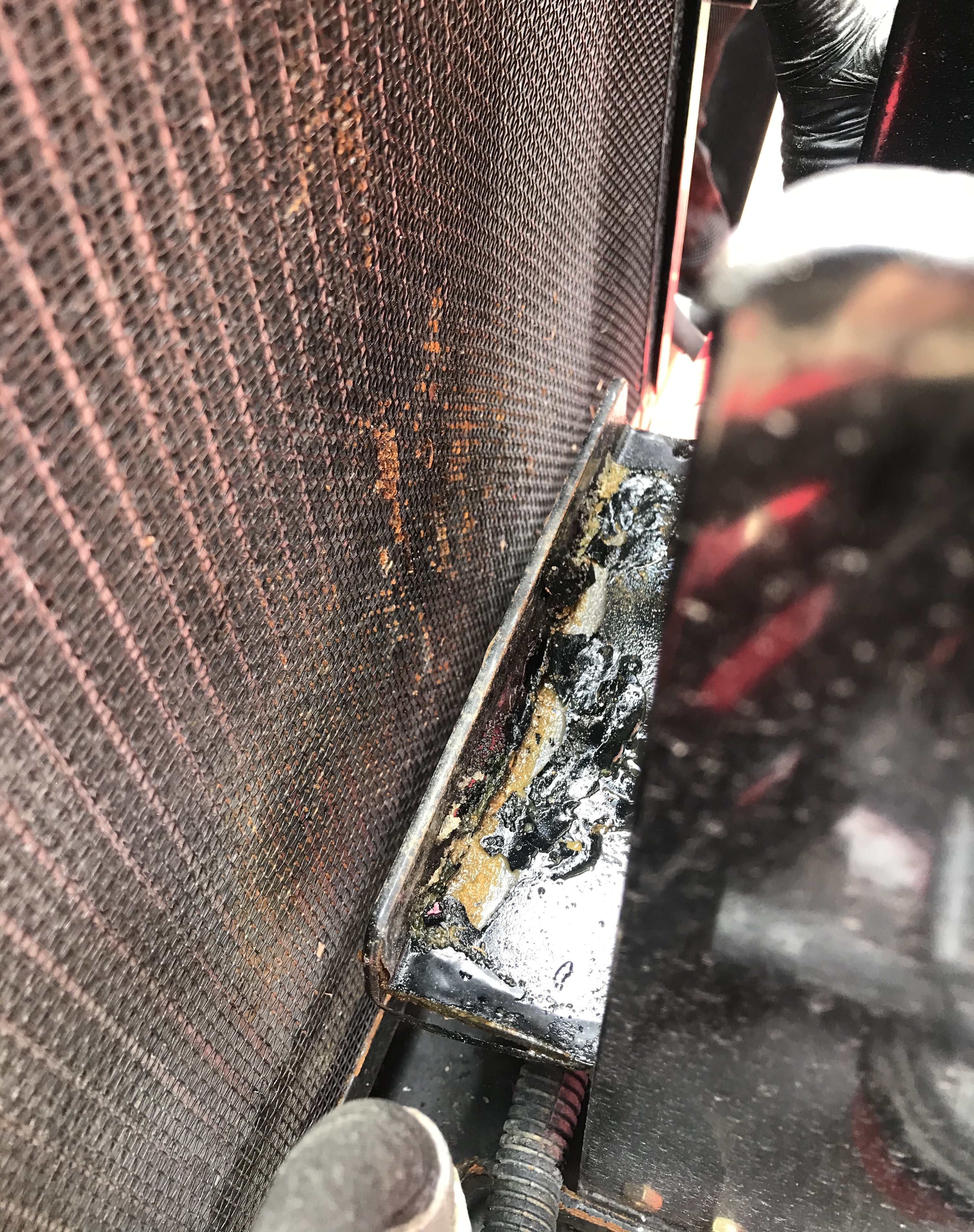

So..... Got her home yesterday, and there was fluid on the deck under the steering wheel.
It was clear and felt like water and not oil or hydraulic fluid so I attributed it to wash water blowing out on the road at 65mph.
Today, however, after 10 minutes of mowing my admittedly lumpy yard there was more. So
this time I confirmed what it was..... Have you ever tasted battery acid? Not my favorite. So,
I removed the screen and found the battery badly leaking from the caps. After removal it turned
out it was seriously over-filled. Fluid should be at the bottom of the necks, it was more than
halfway up. In the attached pictures you can see the amount of fluid I removed from this small battery
to bring it down to the proper level, and that's AFTER a bunch of it leaked out, and the damage done to the battery tray and surrounding area.
I've cleaned it up and painted it, so I'm good, but it made for a somewhat frustrating "first day" especially
since this was 100% human error and preventable. Someone needs to have a chat with the tech that
prepped this unit for delivery. And yes, I sent this story to the dealer.
After that I mowed my entire property (with no more fluid coming from the battery) and must say I am pleased with the performance. I took off the
backhoe and FEL for maneuverability and that was as easy as in the videos. Good stuff. It's a keeper.

I would make sure you clean the radiator real good........................
   / Shame on dealer! #6
I was thinking the same thing, lots and lots of baking soda to neutralize the acid, although whatever damage has been done by now.................Mike
Afraid so. Hosed it all down liberally. Baking soda is caustic. Also not your friend. Dilution is the best thing.
