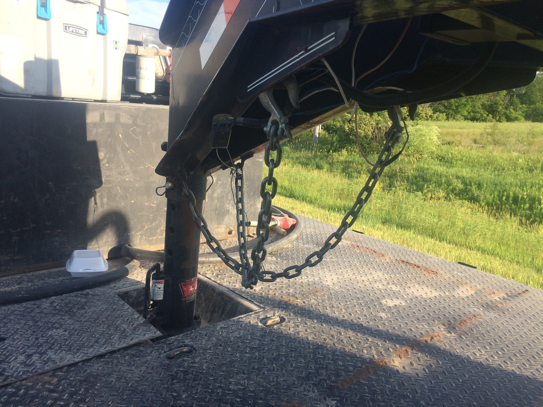

The blatant one is the empty burger container at the front of the trailer. That's why he didn't connect the safety chains, he was to busy eating.
   / Share Pics of People Hauling or Towing Something Wrong #10,674
No safety chains from the trailer to the truck, no tie downs on the bucket, loose pressure washer wand and hose in the bucket, rear tiedowns have no angle to speak of, so they will hold side to side, but not front to back, unsecured styrofoam container on the truck deck, trailer plug broken and falling out of the socket.

The front bucket is unsecured. No safety chains. Unlikely the broken plug works. Front binder is hooked wrong. You really need 4 separate chains but we’ll let that slide. Rear tie down angle is wrong. Slack is dropping through the trailer grate.

From the looks of the breakaway cable this guy has a habit on not connecting the safety chains,
