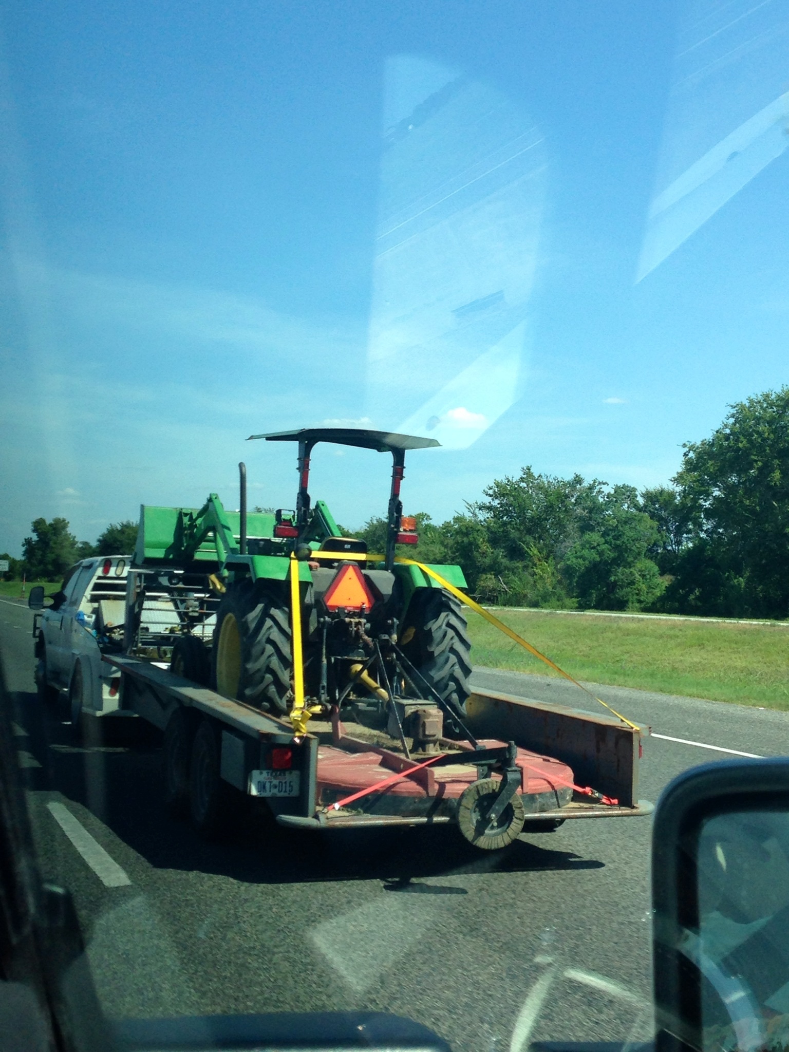

Not the worst I've seen, but chains would be better.

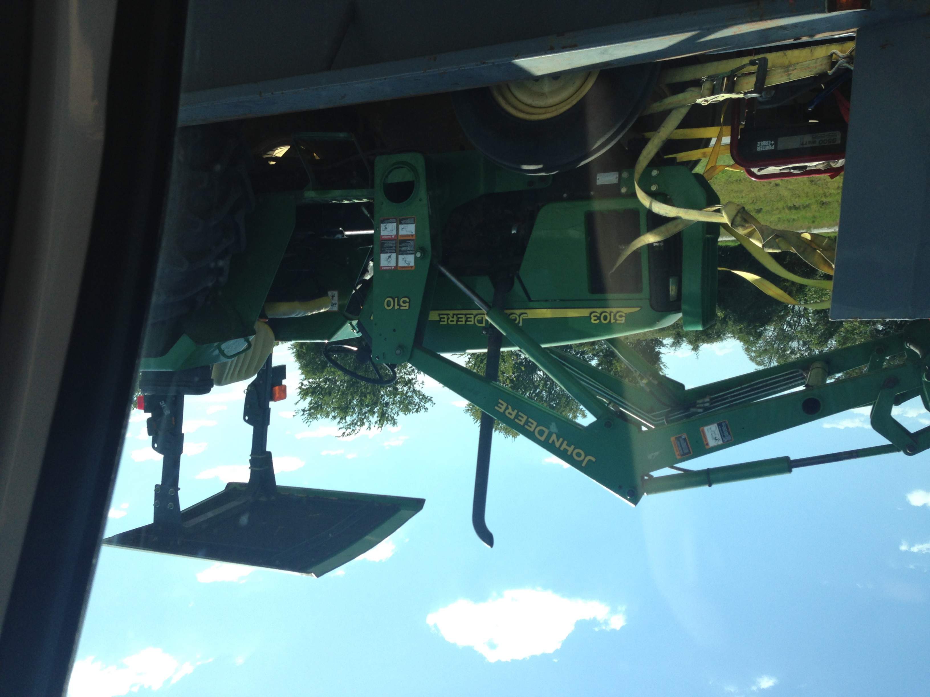

Well the second picture says it will hold upside down....

Not the worst I've seen, but chains would be better. . .
Agreed. I've seen worse, but chains are required on that load.
On this side of the Sabine River, those straps would get you a ticket. Probably would in TX too.

you're kidding me right.... not even 10K lbs. DOT doesn't require chains until 10K lbs
after looking more closely at the pictures i and to take my comment back, but not because of the straps, the fact that th loadr and bushhog aren't strapped bothers me

One single strap across the back is not enough and the small one on the mower would barely count.
4 individual 3" straps(3000 lbs. each) would pass. Plus one for attachment
If one of the 4 breaks, then the other 3 will hold.
