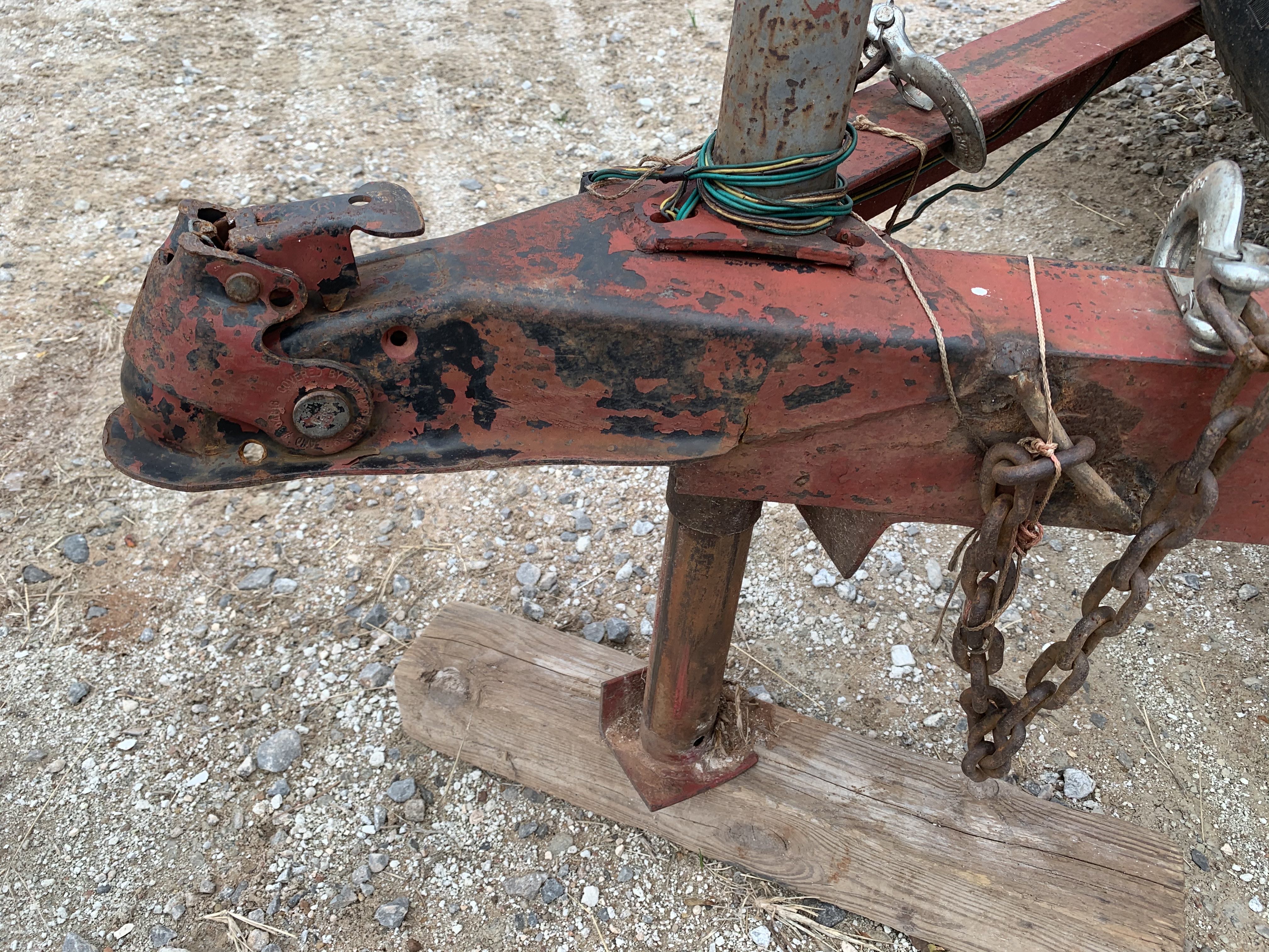

Broke a long standing rule of mine and loaned out a trailor and got this back. As expected the guy had no idea how he loaded so much for the crack to happen. It’s kind of in line with the jack.

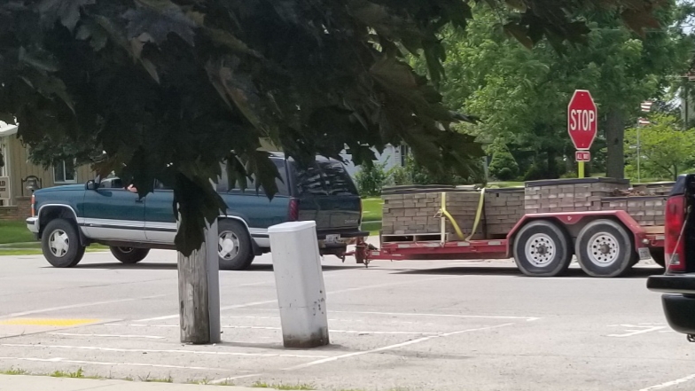

It was 7 pallets. More pictures:
View attachment 662340View attachment 662341
Also, I don't think the cord was plugged in, so no lights or brakes. A half mile in the direction he was coming from the road tee'd into a US highway, and a half mile in the direction he was going the road turned into a back country road (likely 55 mph). It was in the middle of nowhere, so he had low population density on his side. The town where I saw this was small and unincorporated. I only saw him go slow through town.
View attachment 662373View attachment 662374
I never loan vehicles trailers or tractors except to my brother. And he knows how to use them properly.

And sometimes they were already damaged and you didn't notice it.

Those cracks don't really have to do with the jack even though they are lined up with it... it all has to do with the stress concentration at the end of the weld on the tongue, the cracks on both sides line up with the end of the welds... It sucks but if you have a welder not a big deal, it looks like it's been around the block for a while, it happens... At least he obviously had tongue weight so you still have a trailer and neighbor! trailer sway sucks and can get bad... I've literally been towing, couldn't move the load forward and bought tongue weight...
That's very true. I've learned that if I'm going to fix or replace something, I prefer to do it to my own equipment.
