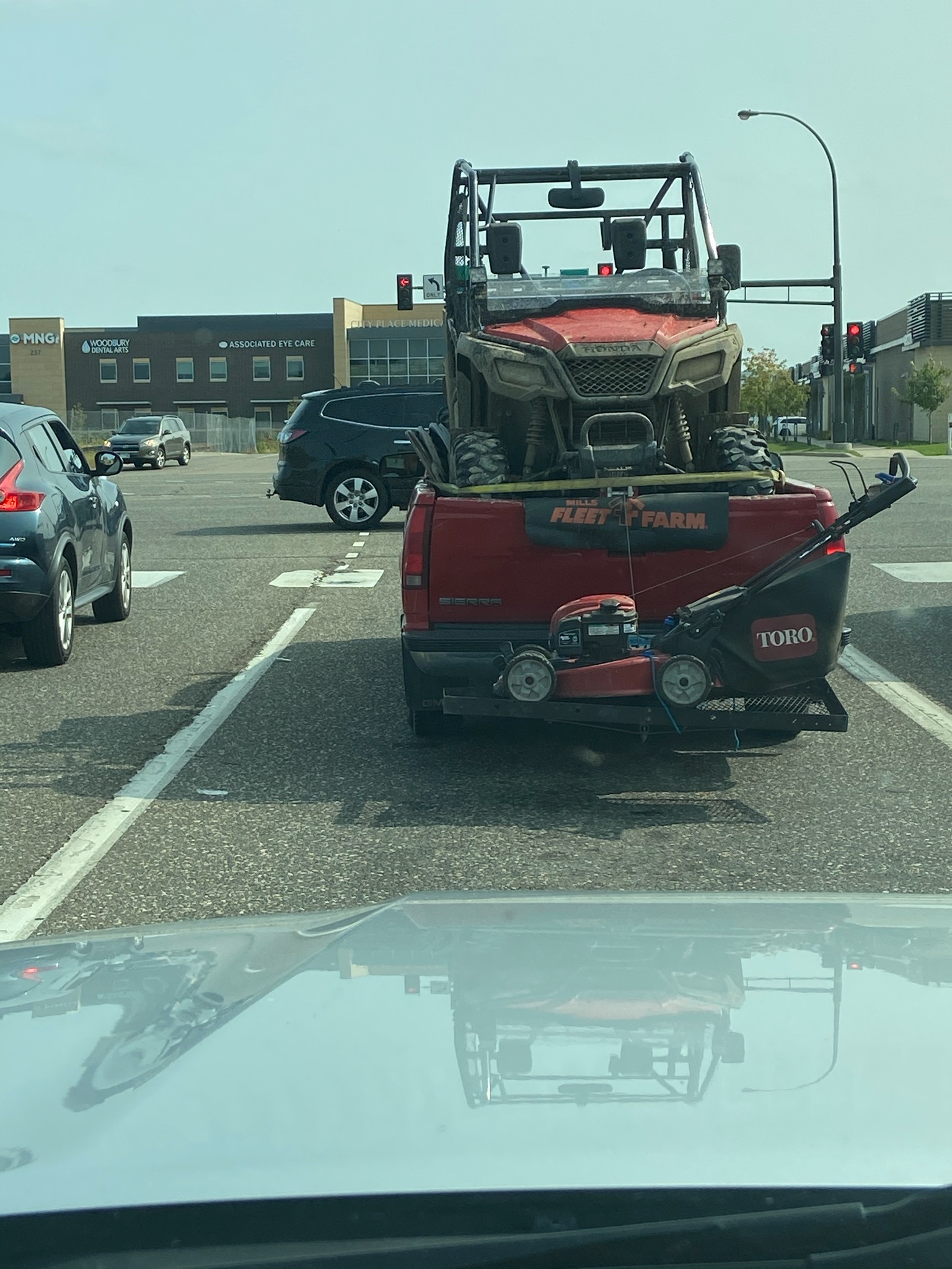

Annnndddd...today's winner. Photo sent by a friend locally here. He didn't get a pic from the side but said it was riding super low. Points for creativity on loading, for sure!
   / Share Pics of People Hauling or Towing Something Wrong #13,157
Meh, 900-1500# of side by side plus a push mower shouldn't be a big deal for most trucks.
Aaron Z
   / Share Pics of People Hauling or Towing Something Wrong #13,158
Aaron Z
Can someone tell me what the SxS winch line is attached to/securing?
   / Share Pics of People Hauling or Towing Something Wrong #13,159
The mower sitting on the hitch mount platform? I don't see a problem with that. The mower is secured.
