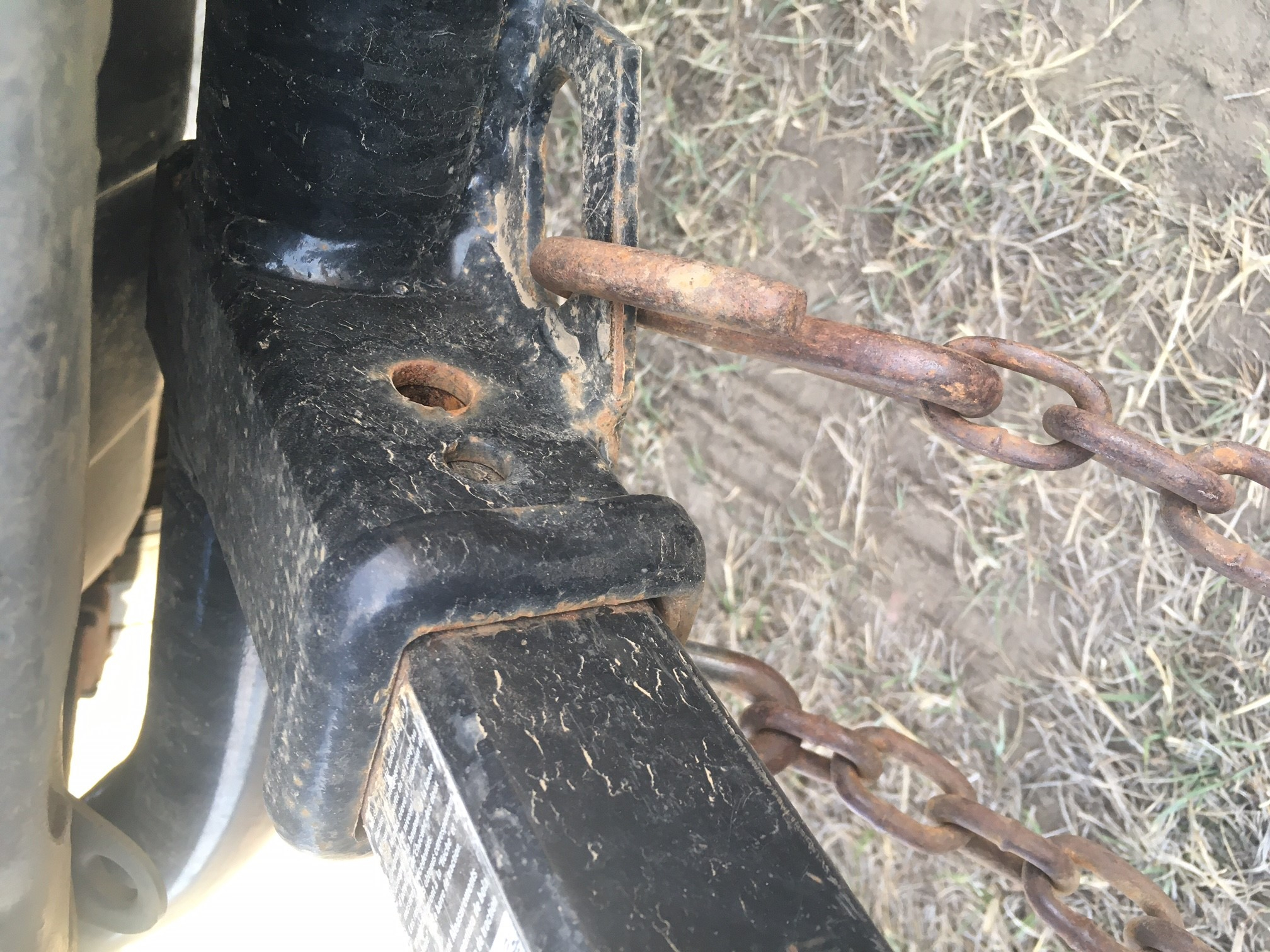

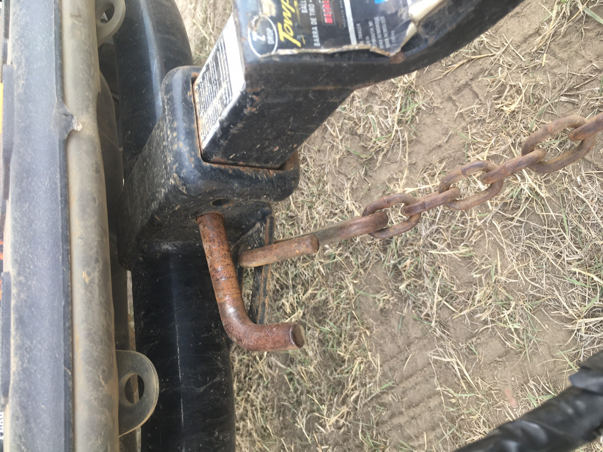

Had an "OH CRAP!!" moment the other night.
After the second car hauled and third loaded in one afternoon, I decided it was too late and I would turn the tongue jack down to take some weight off the tow vehicle for the night.
Before we start the beating, I KNOW I put the clip in because I'm **** about this stuff, double-checking.
But still somehow I found that the clip was gone, and the pin halfway out as in the pictures.

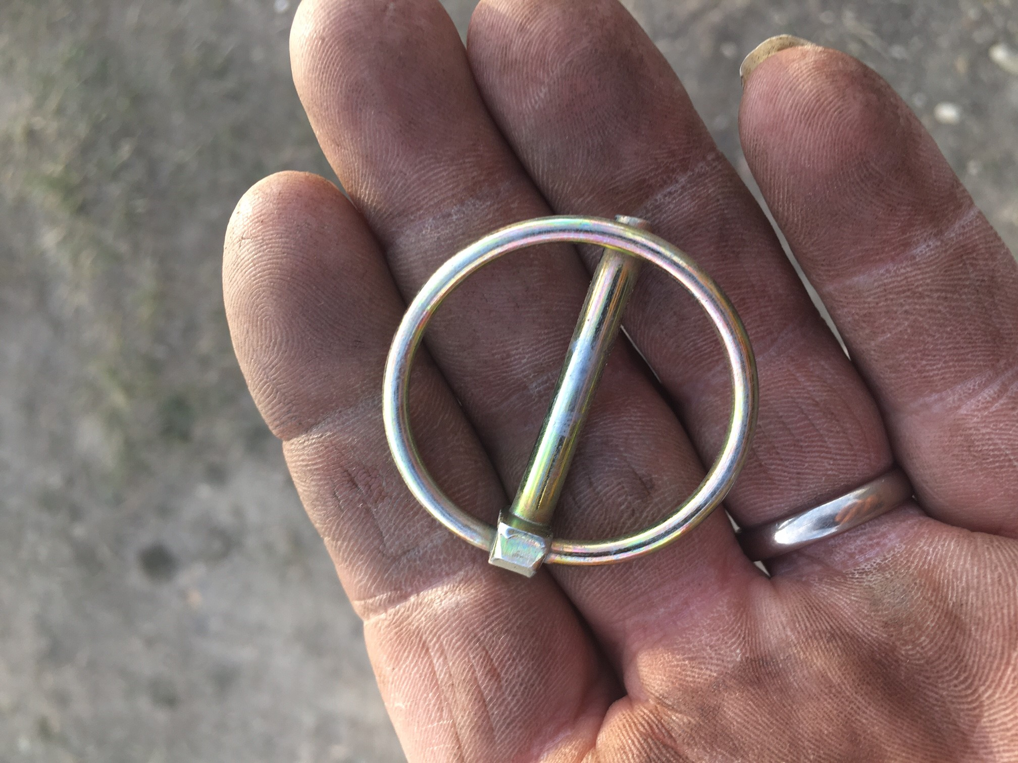

These are the clips I use. Never had an issue before, ever.
Apparently I need to start TRIPLE-checking.

I would upgrade or change to a proper hitch pin, or at least a clevis pin. Those linch pins come out ALL the time on my tractor 3-pt hitch. They just seem to lose tension and vibration can open them right up. Or a bouncing stick/rock, etc.
Personally I prefer a LOCKING hitch pin so there's absolutely no question (and so no one can steal my hitch).
   / Share Pics of People Hauling or Towing Something Wrong #14,374
These? I have lost these in tall grass, thats why I started using linch pins. I am about ready to start using cotter keys. I remove it after every tow, and with 5 tow vehicles, . . I don't really want 5 more locks and keys around either.

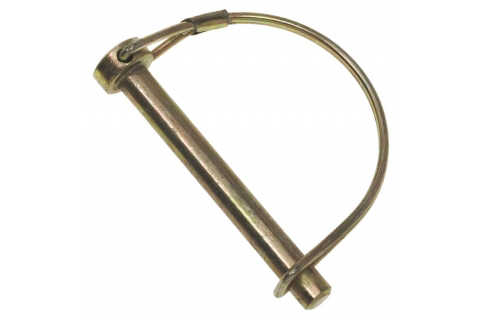

I use the half-circle type like John089 illustrated above, for the latch on my trailer hitch and for what I assume it was intended for - securing the backhoe's hydraulic pump onto the PTO.
