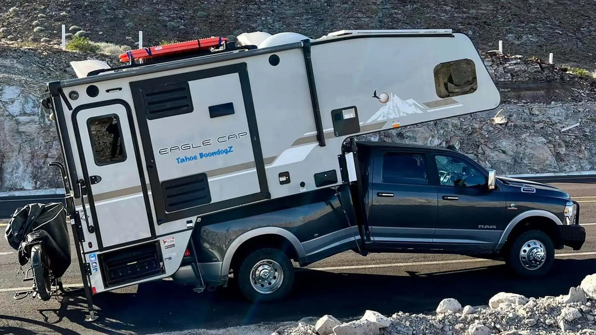

When are dealers/mfg going to stop selling camper setups like this? So much overhang which also includes a slide out and its extra frame weight. Jon
All the Eagle caps except the 811 are between 4500 and 5000 lbs. Crazy heavy. That much weight should only be on a chassis frame designed for it.

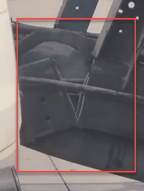

One of the guys on another forum saved a still photo out of the video, clearly broke in the top weld of the bed mount.
Torn in a clean line straight down, it looks like the break is where the frame is spliced. Maybe for varying wheelbase models? Then they welded the bed mount right on that splice.
Seems to me if that is the case then the bed mount project should have included scabbing plates across those factory welds, to spread the stress that is focused at there.

Looks like the aftermarket flatbed was welded to the frame. Aren't you NOT supposed to weld to frames? I've seen stickers on many semi tractor frames saying that.
Those are the factory bed mount brackets, welded from the factory, so Ram, you get a ding.
