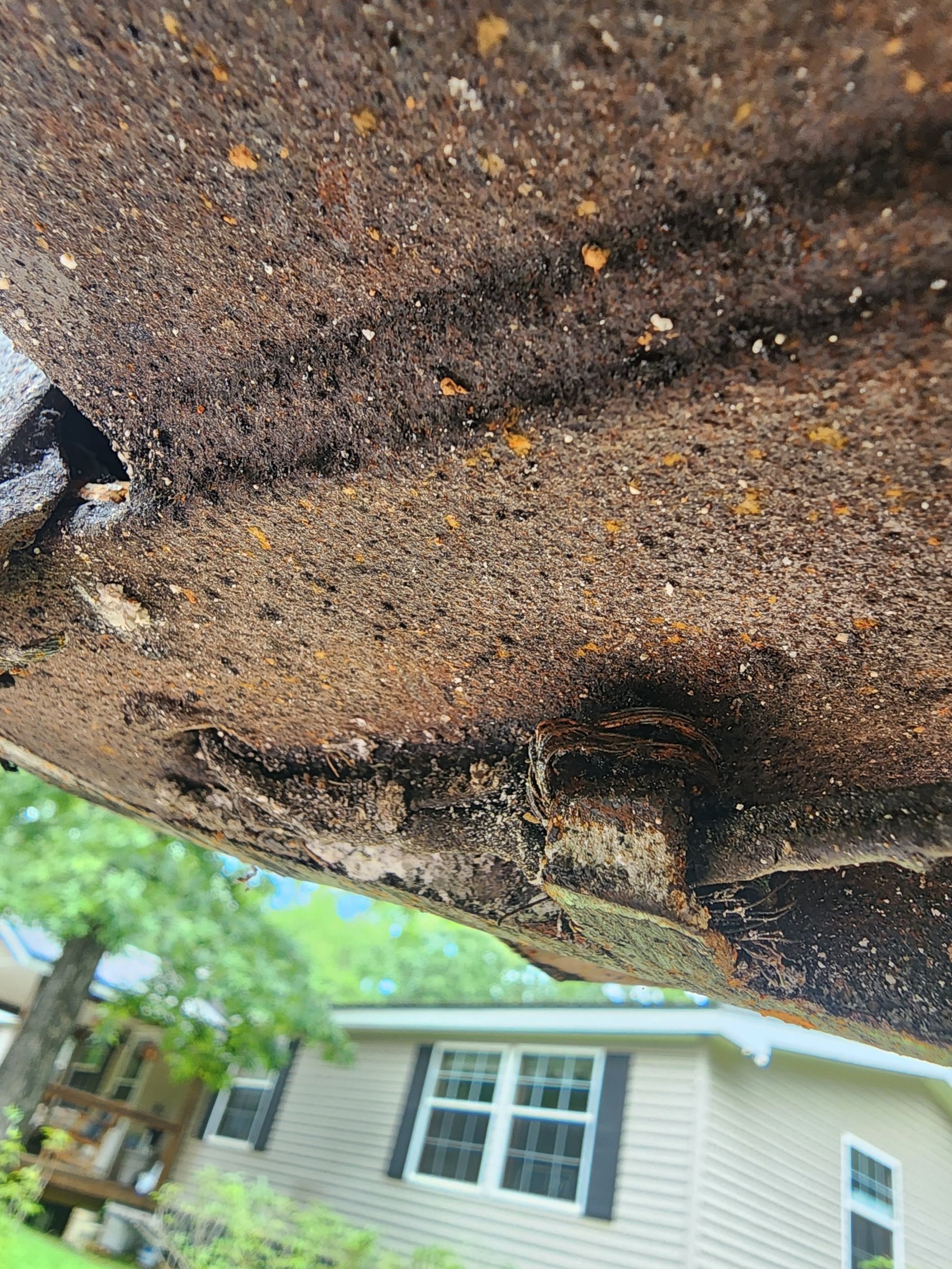

Nah, it's not the springs fault, the nut is still on the spindle but the hub is missing, they've neglected to add grease to the wheel bearings for many many miles, the tire exited the situation then they continued to drive for long enough to wear through the backing plate, U bolts and the springs left the situation too...
you nailed it that is exactly what happened, I replaced the missing hub, springs and tires had to repair the wiring also.
20230719_092457.jpg Look closely and you can see that the metal got so hot it melted the wire going to the tail light.

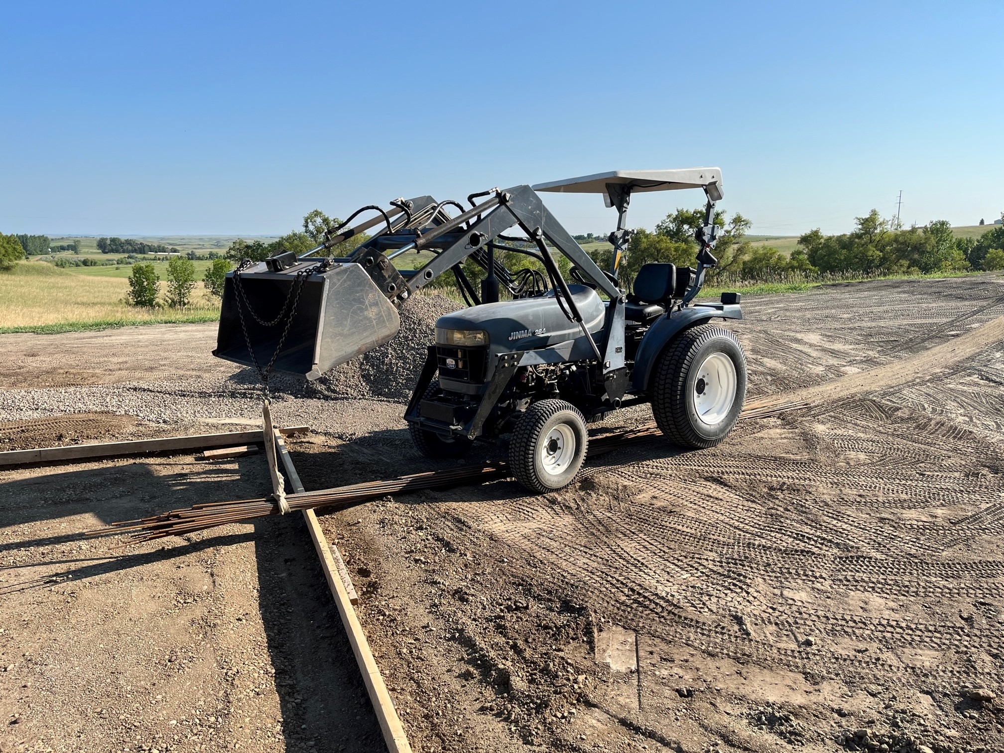

Towing rebar while straddling it to bring it all the way to the forms.
No tight turns!

I've seen that done with pickups carrying rebar and pipe, on the road. Tied up enough to not drag.

I've done that tied front and back but we were not going far and did not get off company property.
