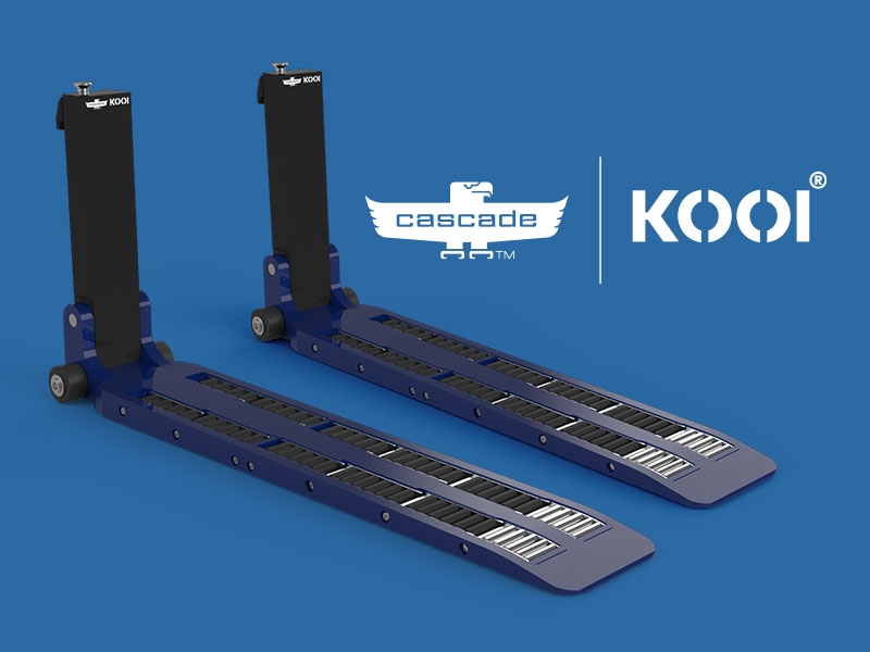

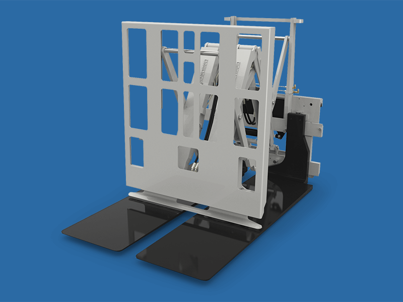

Slip sheet forks or roller forks?

It's not hard to unload as long as you have a dock or a ramp. The dunnage boards are about a quarter of the way from the end. Just put the forks under the end, lift, tilt forward, and push them under the dunnage board. Then tilt back and the forks won't slide out. I pick those up often. And I have unloaded them as well. Long forks will pick them up once they are under as well. I don't pick up full loads just a few bundles as we are an LTL carrier. But they are not hard to move if you can drive the lift onto the trailer.
