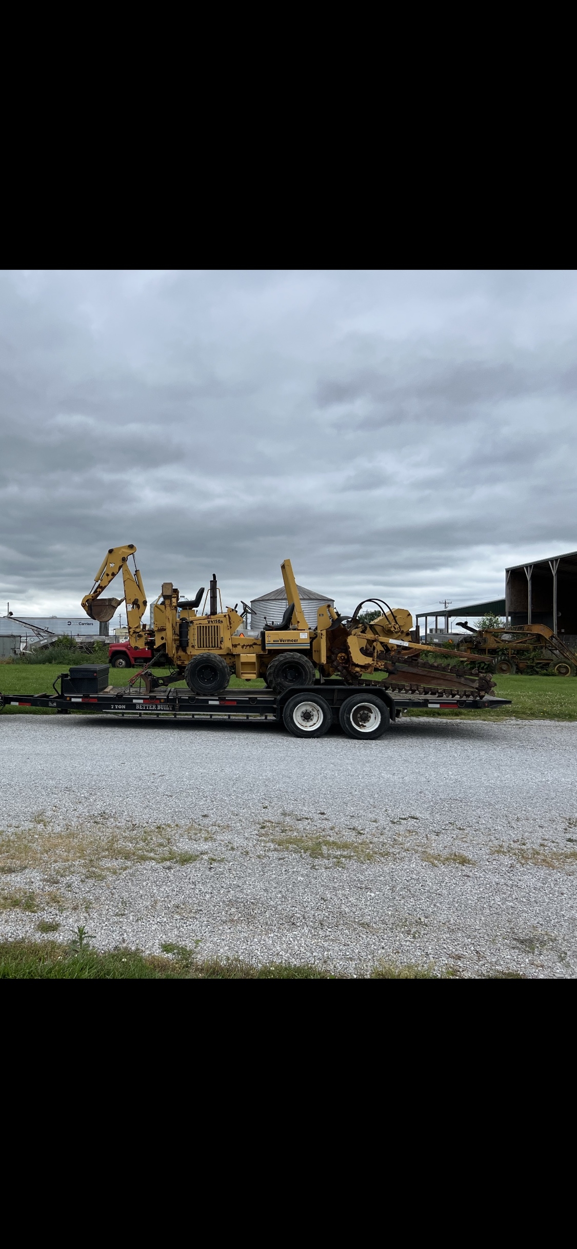

   / Share Pics of People Hauling or Towing Something Wrong #18,860
The last 10-15% of a tilting deck trailer isn't that useful. A normal trailer has the axles around 60-75% of the way back. A tilting deck needs to have the deck balanced & the pivot goes between the axles. So axles on a tilting deck are only 50% of the way back. Way easier to accidentally end up with insufficient tongue weight.
Only considering the trailer frame at least. Not the tongue, gooseneck or a fixed deck infront of the tilt.
I have a power tilt deckover these days rather than gravity tilt. The power hydraulics let it work unbalanced. But it still has axles further forward than a fixed deck.
I’ve never had any problems with the weight distribution on my tilt deck. Of course I can’t park my skid steer on the tail but there’s plenty of deck space to avoid that issue. Resting my trencher boom or tractor bushhog on the tail is no big deal.
