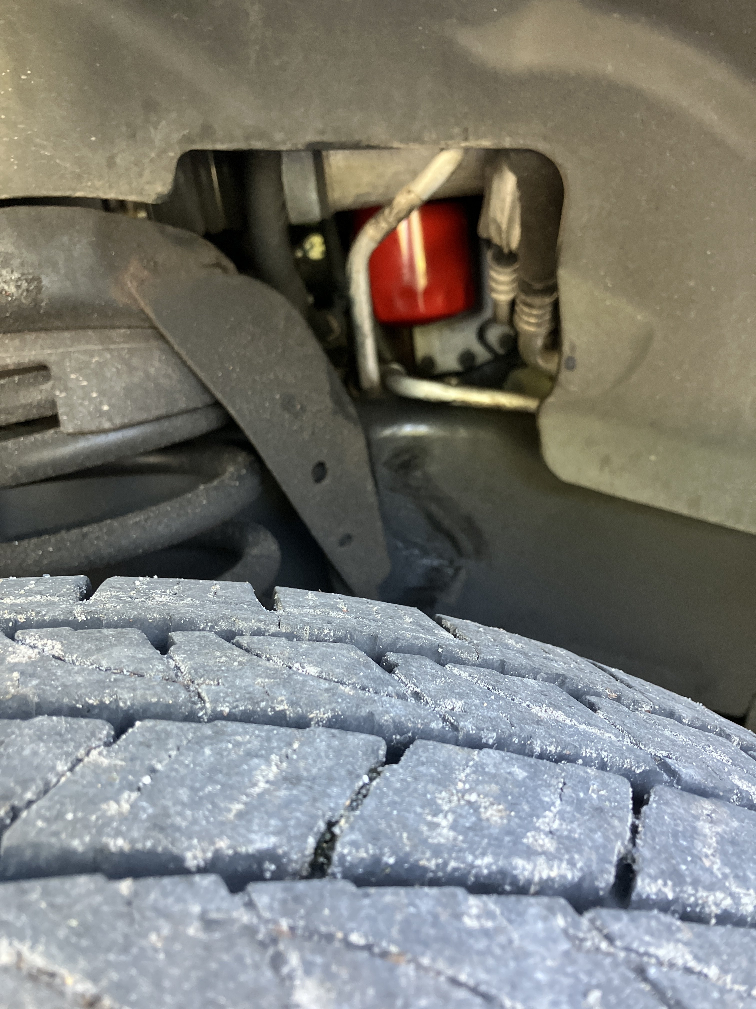

2500 Ram with the Cummins is the same way. You access it from the right wheel well, and have to rotate the filter 90 degrees to snake it out between steel lines. The filter will drop down low enough to screw this piece on, then rotate and remove.

Having just purchased a 2022 Ram 3500 with Cummins this part of the discussion caught my eye. But I went to Amazon and I see all the similar products describe themselves as being for 2013-2018 models. Not having change my Cummins oil yet I'm curious... Is that because the filter has been relocated to a better place 2019+? Or does this still apply?

I can't say if it's needed for your year. Best I can tell you is to look behind your right front tire, as in the picture above. If you can see the oil filter, I'd say it's a similar situation to remove.

It didn't change. Which makes sense since it's really only the front clip that's different on the '19-up models.
You could go in from the top instead, but I don't like to disturb the air intake stuff so I do it through the wheel well, using one of those caps. Plastic bags supposedly works, too, but I've never tried that method.
