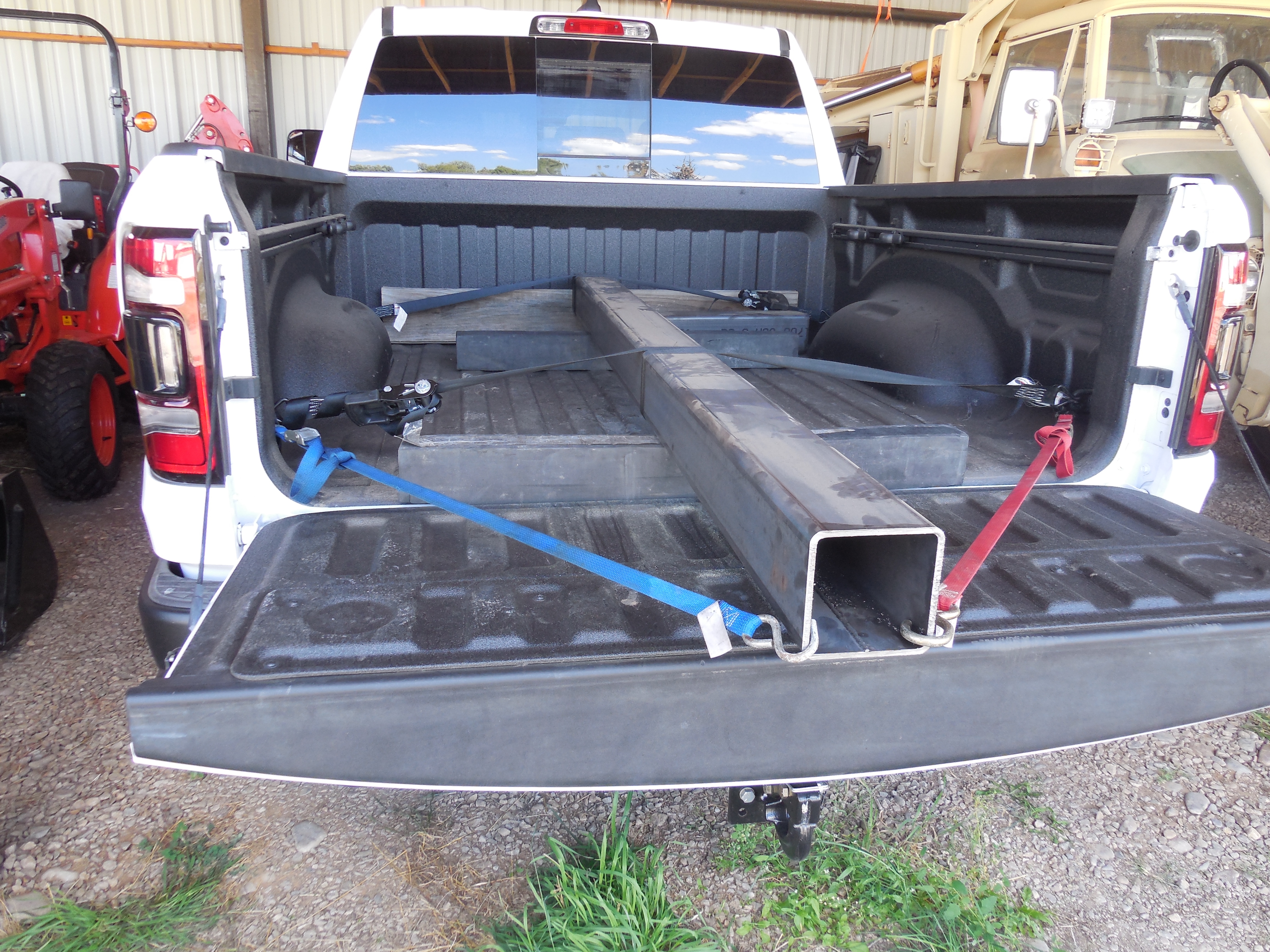

Sort of a thought exercise: Imagine three 4x4's in your pickup bed, tailgate down. Can you run a strap from one side to the other, that holds them down?
Okay, this is one piece of 5x5 square tubing, not 2x4s, but the same principle still applies. Either loop the strap around it or put something under the "load". Done.
In this case I opted for raising the load, partially to save the bedliner, and also because it was easy enough to keep the tubing from being able to move towards the rear. Not a lot of down force needed i this case.
It stayed in place for 150 miles of driving fast on a bumpy and quite curvy road.
