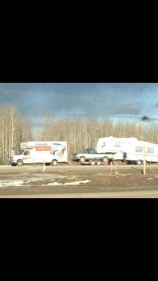

Overloaded?
A bit much for this rig to handle?

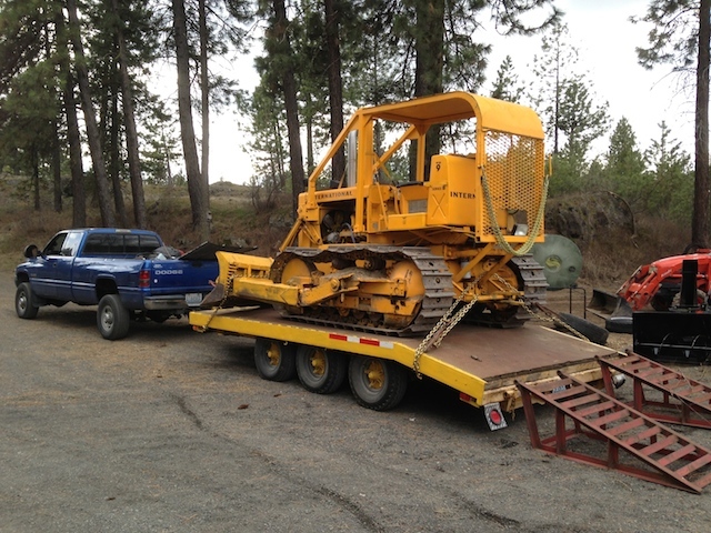

   / Share Pics of People Hauling or Towing Something Wrong #2,870
That rig was just shy of 28,000# and survived several hundred miles around town, however I have vowed to never haul the cat on it again. I nearly lost it last time coming down a modest but long hill. 20k whipping around behind a 3/4 ton was terrifying. Next trip will be hired out to a professional.
