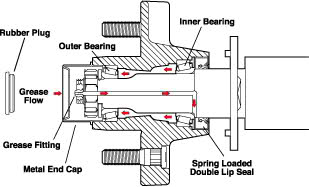

If you have grease-through hubs how often do you fully take things apart to actually check if grease is getting through the seal? You'd never know unless you pulled it apart.

Here is a diagram that shows how the ez lube hub works. The grease goes in through the middle of the hub, then comes out through the inner bearing, and then finally through the outer bearing.
To grease it, I raise the tire off the ground, spin slowly with left hand, grease with manual pistol grip gun in the right hand. With dust cap off you can see when the new grease comes through the outer bearing. It can't get there without going through the inner bearing first.
The key is to spin the tire and grease slowly with a manual gun so that the grease has a chance to move through the whole inner bearing then the whole outer bearing. Without putting excess pressure on the seal.

I have had ez-lube hubs on 5 trailers over the last 15 years or so. 2 Haulmark, 1 Kaufman, 1 PJ, and the current LoadTrail. Never a problem of blown seals, greasy brakes, or anything else. Not hard to get it right either. I just read and followed the axle manufacturer's instructions.

I never pulled a hub on any of those trailers.
I volunteered to drive the band trailer for the high school a few years ago, and the trailer was loaned by a former band parent. When I picked it up from his house, he assured me he just checked tire pressure, greased the hubs, etc. He handed me a small tub of grease and said "just pop those off and smear the grease there" as he pointed to the rubber plugs. Hmmm. I got it home, and checked for myself. Ssure enough he had popped off the rubber plugs and packed the area full of grease, right over the axle nut and zerk. They were ez lube hubs but apparently he didn't know what a grease fitting was or how to properly pull the hub to grease it 'old school'. When we pulled the hubs to check them, it was obvious the hadn't been lubed in years. Oh, and the tires had under 20 lbs of pressure. I went over everything on it after that, bringing it up to safe standards for him (for the school really). It makes me think about how other trailers are maintained when I see them on the road.

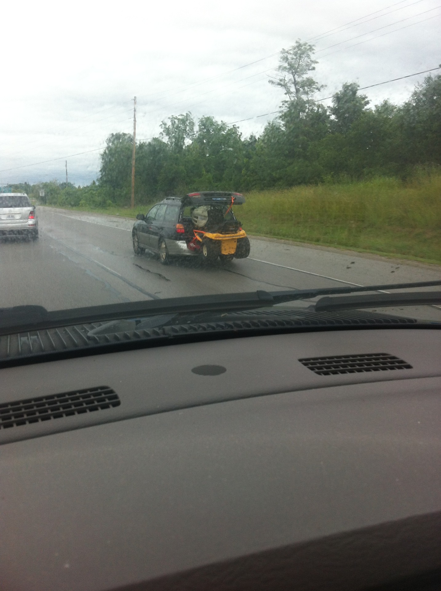

It's under the hatch to keep it dry, they strap it to the roof in good weather...?
