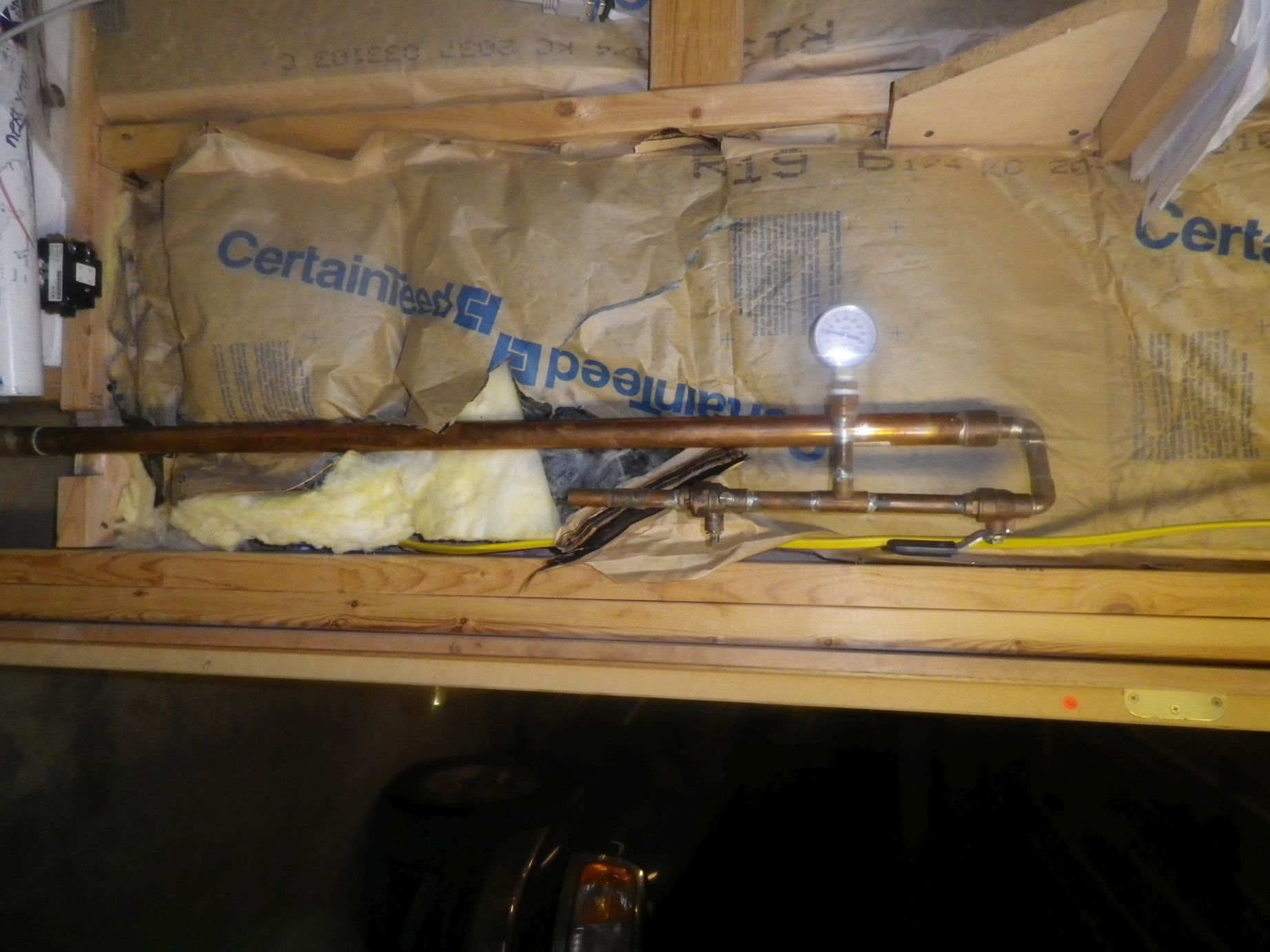

My outside loop is in our pond. When the system was new I could hear air going through the flow center every few minutes. Therefore I added a "stand pipe" just above the flow center, That would collect the air I could blow off. When I was at it I added a pressure gauge I had laying around. The picture should be rotated.

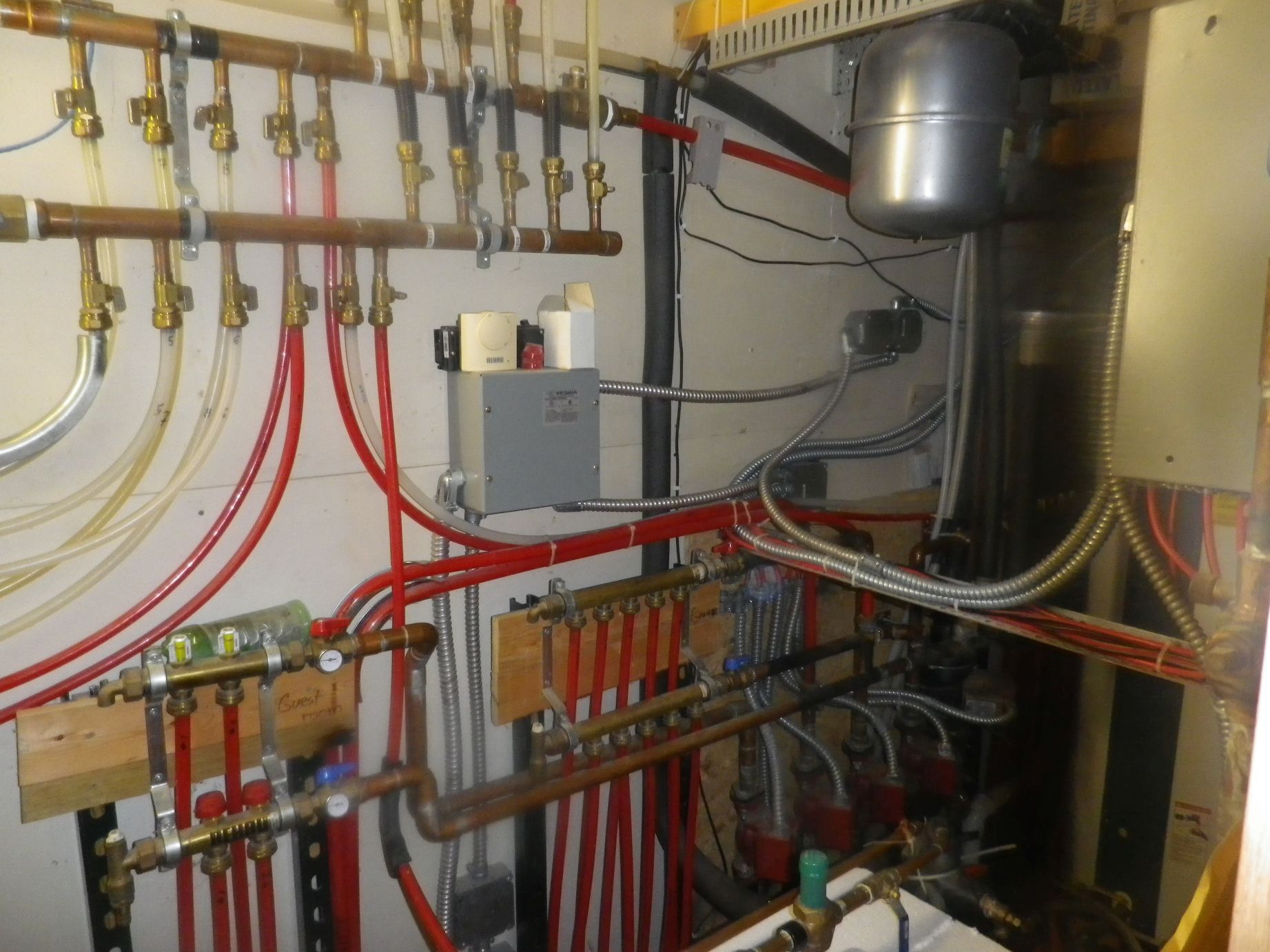

Here are pumps for floor loops and fan coil. There is a high pressure fan coil in the attic for AC. All duct are square fiberglass 8"x 8" x 1" wall. Very easy to install because you can cut those with a kitchen knife. All taped together with aluminum tape and several layers of duct tape over it. Vents are fed by insulated noise attenuating 2" ID flexible tubing. Home :: The Unico System

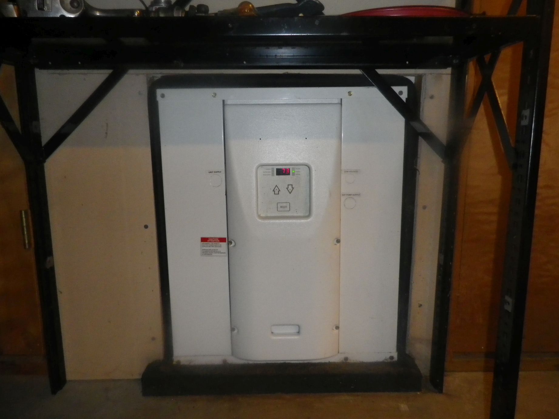

Make sure all piping that could get cold is insulated with two layers of closed cell insulation. Otherwise it will drip water.
Front of the HP protrudes through the wall of the utility closet.
