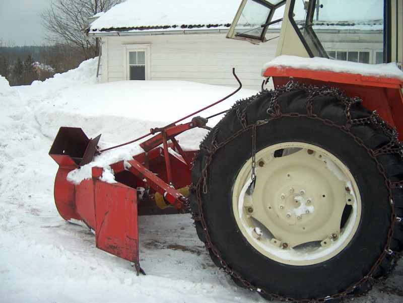

I've studied your photo Gunnar and I have a question about your tractor/snowblower. I don't see any tracks in the snow between the tractor and camera. That suggests the tractor is moving towards the camera yet the snowblower is behind the tractor. Is this a rear mounted, pull type snowblower? Or maybe you're working backwards over your tracks for the sake of the photo? Either way, it makes a great shot but please cure my curiosity /forums/images/graemlins/smile.gif

It is a self made V type blower

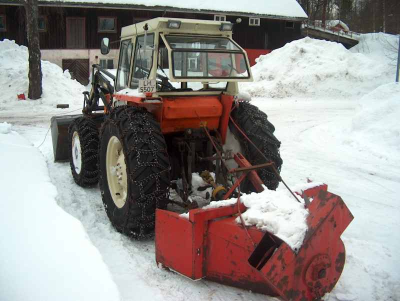

another pic

Aha! Mystery solved, thanks. Very interesting setup. Any issues in really deep snow?

I have always wondered about the mounting of snow blowers in the USA versus Norway. Over here I would say that most tractor mounted snow blowers are pull type. Meaning that the tractor drives over the snow it's then blowing.
I haven't seen much of a problem in doing so, and it's easier on the back / neck to just put it in gear and drive forward versus backing up as you blow the snow away.
It takes quite a bit of snow to stop a tractor so to speak.
I wondered about buying a blower for my BX. I ended up with buying a used pull type instead of the original front mounted blower. It hasn't been so much snow around here since the mid 60's and it has worked fine for me. Gives me both the loader and the blower. When it's a lot of snow I just lower the loader a bit and drive forward as the blower takes care of what I leave for it. Works very well for me.
