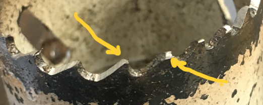

Yes it can be done, easily done.
(Probably just once though.)
Holesaw was visibly dull and I wondered if it was gonna cut at all?
Well, It did ..... about halfway, smoking the oil, and hardly any chips (only dust) coming out.
Some of you have Been There Done That?
So using a narrow kerf cutoff wheel in the angle grinder I gave a little love-tap to the backside of each tooth.
606329d1558884888-sharpen-dull-holesaw-yes-works-740d802e-0f6e-47b3-9ae8-a07828655171
This pic you can see the 3 rightmost teeth are untouched, you can see the flat spots ( DULL ! ).
And you see grinding on the sharpened teeth on the left teeth.
I inspected each tooth again after this pic, giving the teeth that didn't have a cutting edge another love tap.
Note that saw teeth are bent (alternately) inward and outward (called "the set).
You don't want to grind too far down (to lose the set) or there's no room for the saw to eject chips.
Or to pry out the round plug when you're done.
With that in mind, I kinda doubt you can sharpen a holesaw more than once.
This is a 1-3/4 holesaw, theres not that many teeth.

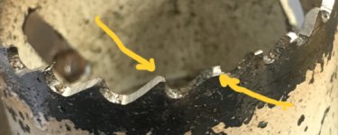

606333d1558886219-sharpen-dull-holesaw-yes-works-76b2bc5f-fb24-4e46-9f1b-43d373330b8b
It took less than 5 minutes to do this and then it cut very well.
Maybe not as good as a new saw - but pretty good dang-it -
Its good enough to put this old cutter back in the drawer (rather than throw it away just yet).
This could be a problem, as in the past I'd discard them,
-and remember to buy a new one of that size.
but now Im inclined to keep them even if dull, and then forget what size I need to replenish.
Ya know - when you NEED that size.... and its 5 minutes to sharpen...
Or 30 minutes roundtrip to the store.
....or my case today, out here in the woods, 90 minutes roundtrip....

using a dremel is a lot safer, and notice the teeth reverse direction of grind angle each tooth.. that prevents binding.
   / Sharpen a dull holesaw (YES it works!)
RADIOS1 I didn't grind on the cutting edge, I just took material off the backside of the tooth to get a 'point'.
Agreed a Dremel and magnifying glasses could get more re-sharpens out of a holesaw.
And re-sharpening it BEFORE the teeth are flat ontop.
But in this case I had the proper size but DULL,
and wanted the hole done NOW,
No time for a "proper" saw sharpening (as often the case)
...and intended to get a new holesaw for next time (that too).
Which I was successful with regards to my goal....... but probably won't be (in remembering to replace it)

I agree with 4570Man and I also have sharpened a no of hole saws with a dremel tool but on the cutting face .
