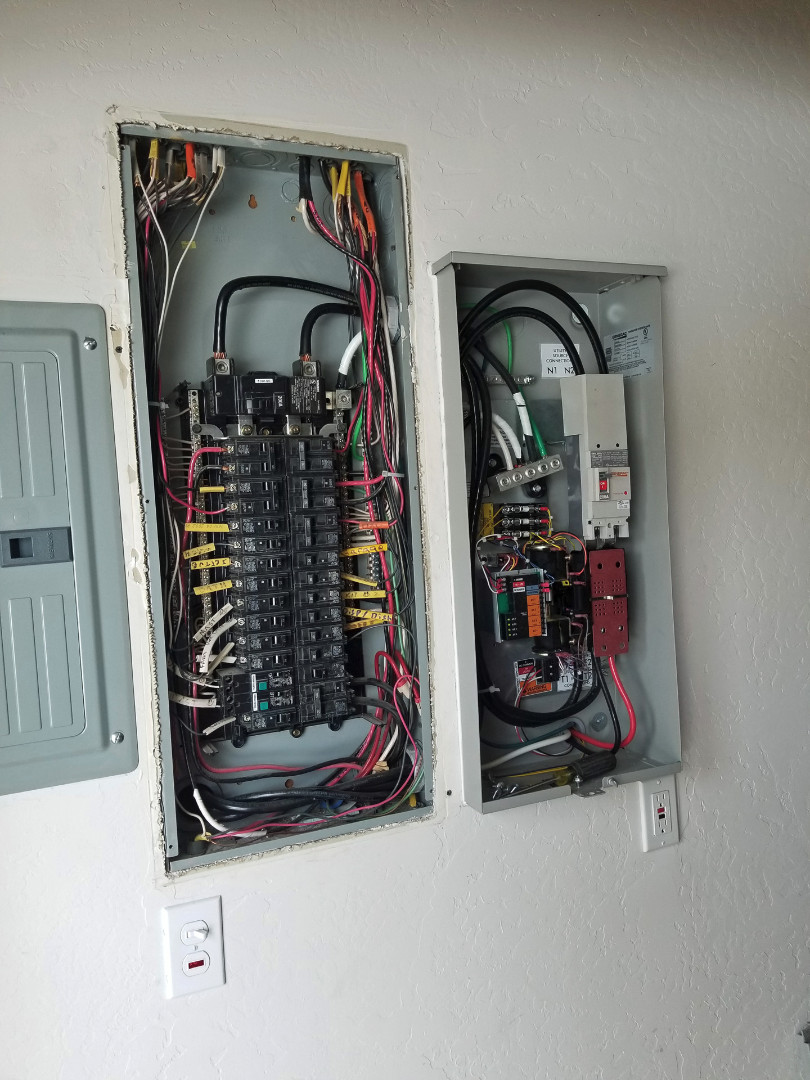

when cutting a 2-1/2" hole horizontally to install a transfer switch, i cannot use lube or drill vertically. My holesaws were drilled at slow speed, but sometimes never made it thru one hole without dulling. the carbide bits dont seem to have that issue.
Why not use a knockout punch tool?
The electrician at work has a older Greenlee one like this: https://www.homedepot.com/p/Eclipse-Tools-Hydraulic-Knockout-Tuff-Punch-Kit-902-482/20630329 that goes from 1/2” up to 2 1/2” and works like a charm to punch holes for conduit...

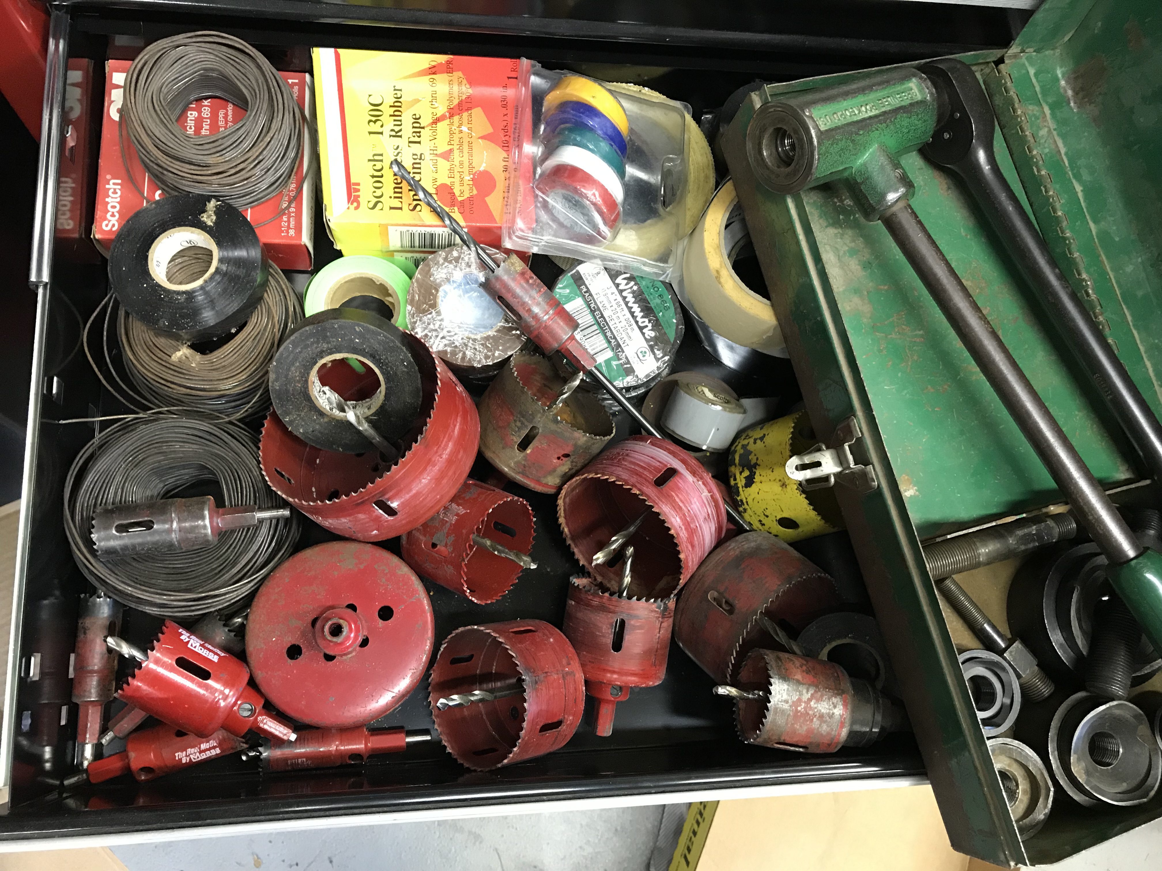

Been making holes in things since 1968, especially sheet metal. Vast majority have been in sheet metal up to 16ga. Hole Saws are still used in some cases, but are not the first choice. For holes in electrical enclosures, KO punches are the first choice. In recent years we've gone to battery powered Gator or Milwaukee punches for most of the work. The ratchet punch in the photo was a freebie from work when we went batter powered several years ago. Handy for home and easier than the old manual punch set I bought 40-some years ago.
When we do use hole saws at work, they are generally used at low speed and dry. Lifespan isn't that bad. It helps if the saw isn't pressed against the material so the entire saw makes contact. A slight rotation (orbit?) of the drill so the saw only makes contact in a small area works best. The blade seems to run cooler and the slug doesn't get stuck in the saw. For smaller conduit holes, the DeWalt Impact Ready hole saws are sometimes an exception to the KO punch usage. They're super for doing pilot holes for the big KO punches. With any hole saw, we need to be conscious of chips around electrical equipment.
For thick materials, the weapon of choice is an annular cutter. A little of the special lube (that looks like ear wax) and the bits last almost forever. At home I've had to make up to 1" holes in 1/2" thick steel. I used a battery drill and a gentle stream of water from a garden hose to flush chips and keep things cool.
This assortment takes care of most of my homeowner needs.

I have a hydraulic punch kit. But I'm installing the transfer switch recessed in next stud bay and drilling 2 of the 2-1/2 holes thru both panels and the stud. Punch kit wont work. My greenly hydraulic kit punches up to 4 inch holes, but the panel would have to be removed from wall to operate punch20190123_110151[1].jpg
   / Sharpen a dull holesaw (YES it works!) #17
Ah, it's that pesky two-by-four in the middle that makes the punch unworkable.
