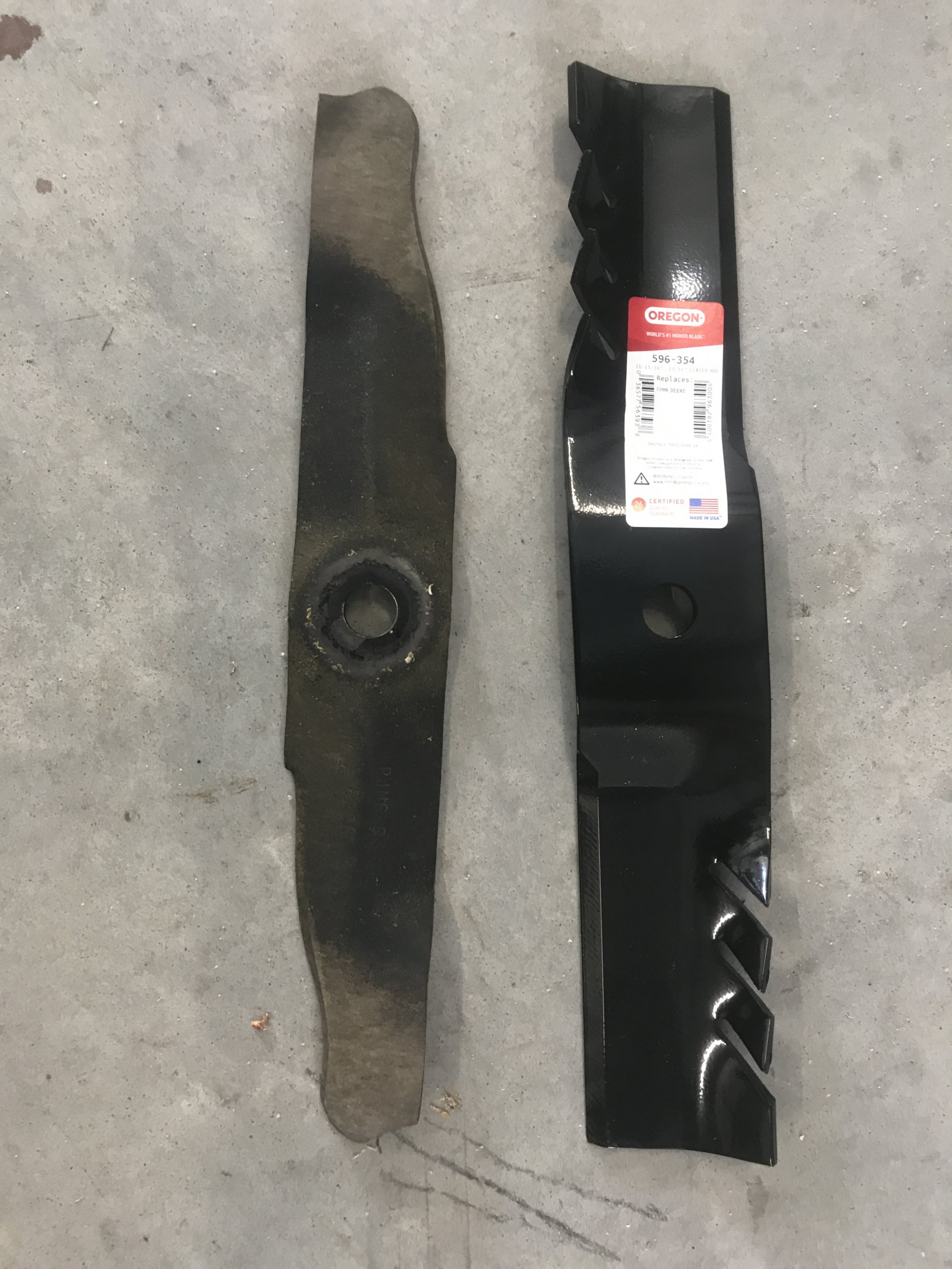

The underside of my beautiful mower is surprisingly clean, most of my ground here is sand so its like it gets sandblasted all the time. I have to replace blades on my riding mower about every other year!
