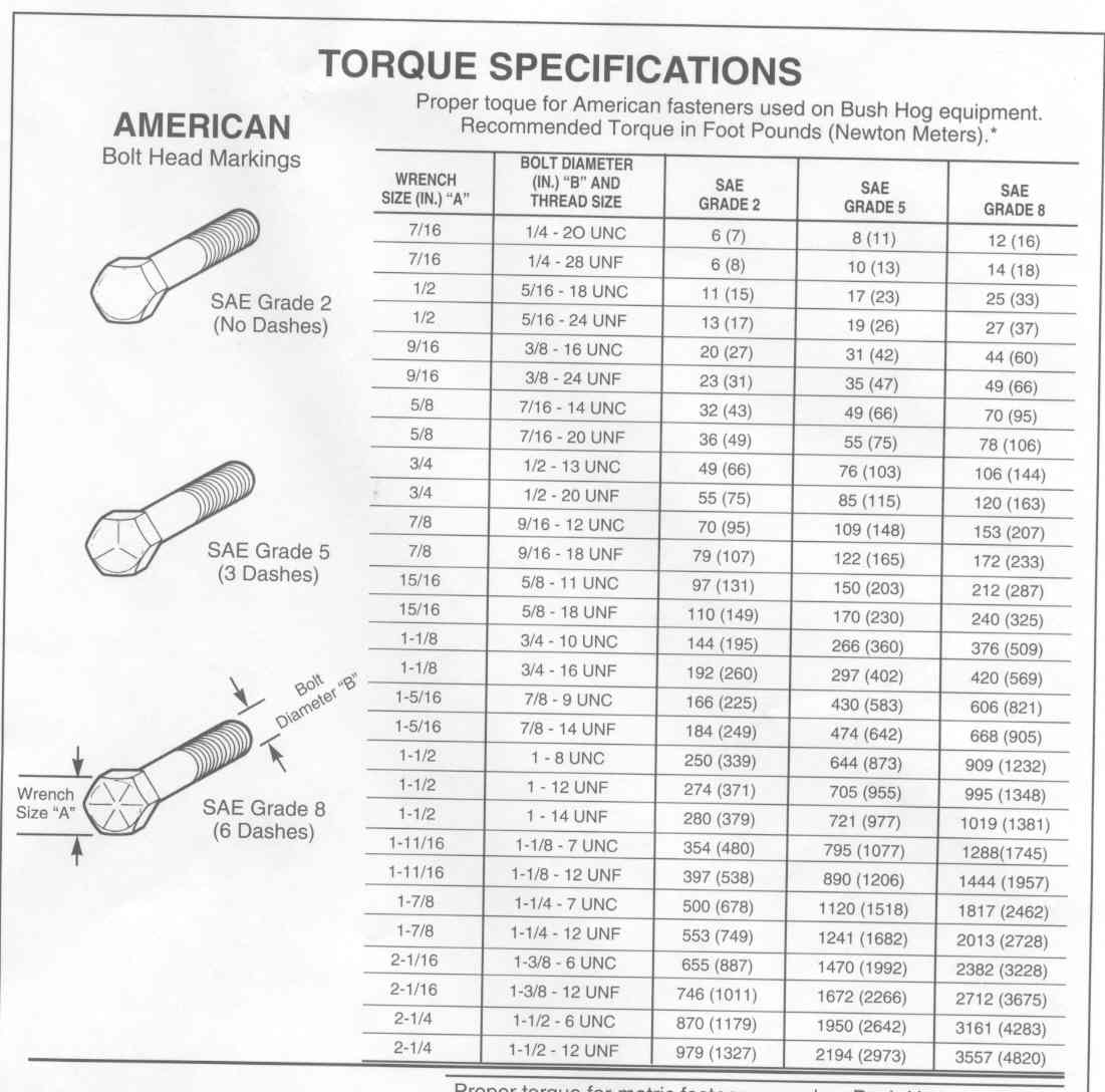

I stopped at my local TSC to buy some 1/2 x 3" Grade 2 shear bolts for my Brush Bull rotary mower. They didn't have any and the salesman said, "All the guys are using regular bolts of the same size." So, I went over to the fastener section. They had Grade 8, Grade 5 and Steel bolts, according to the labels on the drawers. No Grade 2 bolts. Is it OK to replace a shear bolt with a regular Grade 2 bolt?
   / Shear Bolt vs Regular Bolt #2
Mike, stick with the grade 2 even if you have to go elsewhere to find it. The higher grades will be tougher and may not shear when they need to. That could result in damage to your PTO driveline. As I recall, grade 2 will have NO markings on the head. The other grades will have various raised marks forged into the bolt heads. Hope this helps /w3tcompact/icons/smile.gif

This is out of my Bush Hog Rotary Cutter Manual.
