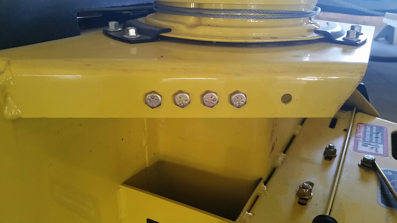

Should I buy JD Shear Pins for my 54" snowblower or get some at my Local Ace Hardware?

Use the JD shear bolts. The bolt is only $0.46 and the nut is only $0.25. Then you will know you have the correct bolts to shear properly.
As you know, your 54" blower housing already has four spare shear bolts mounted on the left side to the rear of the auger housing.
The JD bolt is rated as grade "A17D" which is equivalent to Grade-5

I have a 54" snowblower. Here is a pic of the original shear pins. As yo u can see it is a grade 5 bolt 1 inch long.

A shear pin is just a bolt and usually a grade 2 with no markings on the head. Some things use a grade 5 and are identified by three marks on the head. Just check the owner's manual and buy bolts at the local farm store in the bulk bin.

What I found is that 'hardware store grade' bolts stretch and distort B4 they shear while a grade 5 makes a nice clean break.
The trick is to not have a thread in the shear area as that is a built in fault so to speak.
I don't torque up tight, just snug and always use a nylon lock nut.
The softer bolts once sheared are hard to drive out while a grade 5 will simply pop out easily with the outers usually long gone and it is simply a bit tricky to align the holes to press out the captive shaft remnant (that is on the augers) an my fan I never find either halves, LOL. (I have a gravel drive)
Oh, I located a manual at one time and the factory actually did call for grade 5.
