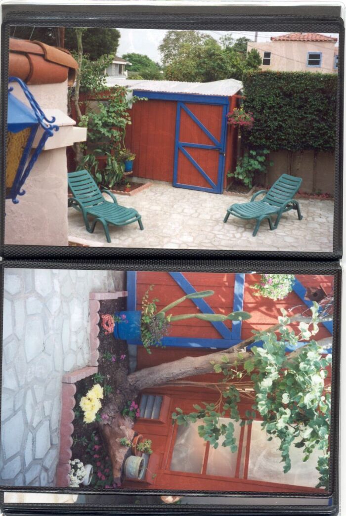

/ Shed Door #15
Some folks like the way cedar weathers naturally, I don't.
I made an "L" shaped shed with 4x8 ft sliding doors at each end. For each, I used a 4x8 sheet of siding that was made to look like vertical cedar boards and trimmed it with 2x4 redwood all the way round with a horizontal piece in the center and a diagonal across both the top and bottom halves. A lot of redwood. I could easily have used 1x3 or 1x4 redwood but had some rough 4x4 posts so I ripped and milled them a tad. I glued and nailed redwood (maybe red cedar???) battens over the imitation joints between the vertical imitation cedar boards of the pattern on the siding. I used redwood stain on the siding and the trim boards.
These weren't real light but did not warp in 10-12 years when I redid the stain, darkening it and painted the redwood dark blue to color coordinate with the house trim (heresy right, painting redwood dark blue..) and are still fine after 15 years. To make the doors lighter they could be trimmed out with lighter wood than I used. I suspended them from a Stanley brand track hung from a redwood 4x4 over the opening and put a facia of the siding to hide the track and gap at the top. Looked really good.
I had some pebble grain aluminum in 4x8 ft sheets which would have made a warp free door and could have been trimmed in 1x2 or 1x3 pine. Would have to be careful to prime the aluminum properly to accept some sort of barn red paint to get the same look. This would have definitely been warp free and way lighter.
Sorry for my laziness in not taking the pix out of the binder so one is sideways but you get the idea. You can see both doors. Makes my back and knees hurt just to see the courtyard paving, I cast every one of those pavers out of cement that I mixed on site. At least the grouting was easy. Mix up premade mortar mix with no water and dump out on the courtyard. Sweep into cracks with a broom. With the hose adjusted to a fine mist, wash off the tops of the pavers. the water runs in the cracks and sets the mortar. After it starts to set, you can add more water without washing the grout out and voila, you're done. I wasted an hour or so with a itsy bitsy trowel trying to mortar the joints before "getting wise".
Good luck to you however you solve the door issue.
