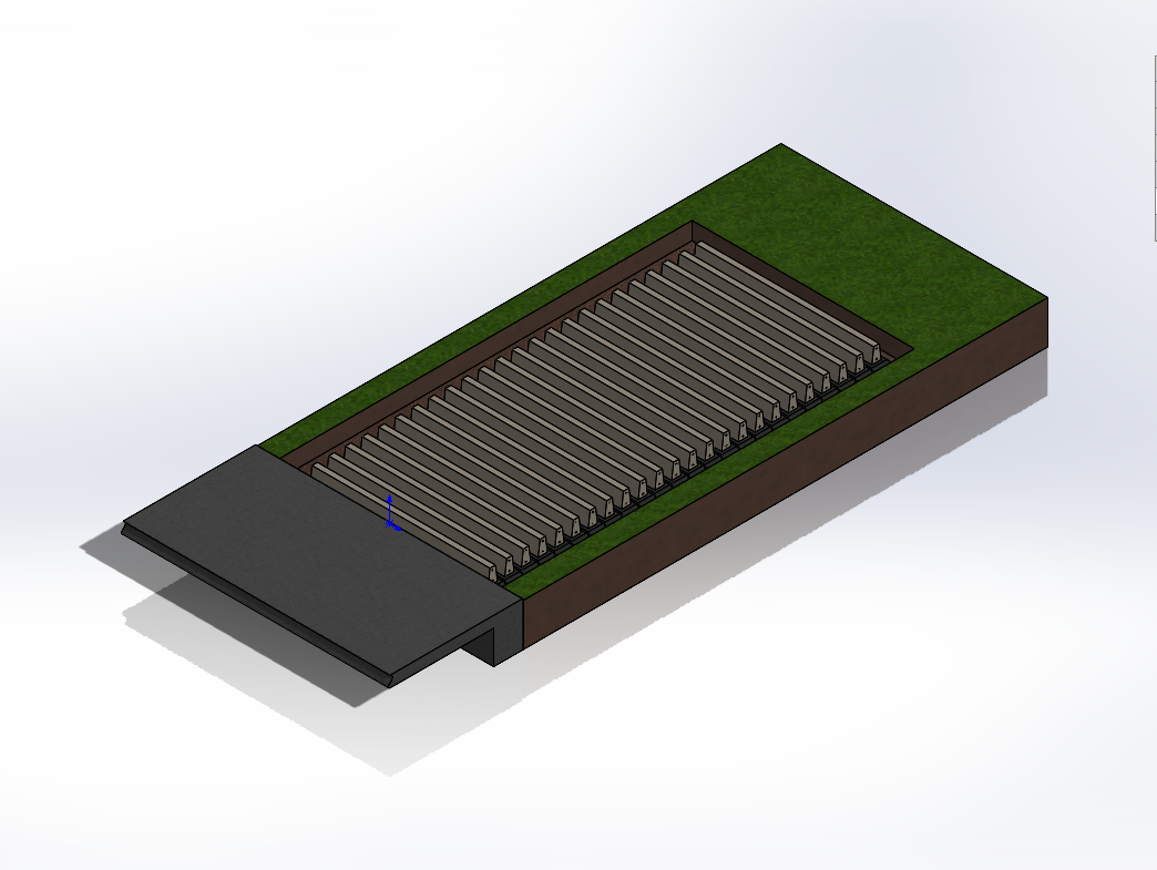

The concrete lintels or parking stops would probably not break, they're rebar'd appropriately. If I did my own pour, you'd better believe it'll have several full-length rebars in each plinth. It won't break.
The issue I have with individual pavers or grid sections is that they do very little to actually spread the load. Figure I have 1000 - 1500 lb. per tire, with a contact patch of roughly 6x6 inches on front tire (~30 PSI) and maybe 10x10 inches on rear tire (~15 PSI). A 12x12 paver would indeed lower the impact of the front tires, maybe as much as 4x if I center the tire on the thing. But it really wouldn't change the soil loading much of the rear tires, whose contact patch is already nearly as large as the paver itself.
A parking plinth that has a footprint of 8" x 96" would be spreading the load of two tires over an 8" x 48" section, knocking front tire impact down from roughly 30 PSI to less than 3 PSI. A 4x8x96 lintel stood on edge (strong direction) would be half that footprint, so 6 PSI... still infinitely better than a 12x12 paver 18" or 24" grid sections. All that matters in these situatiosn is soil PSI, and maximizing footprint of the concrete is usually the best solution.
I had also thought of highway fabric, just as MMC suggests. It might be a good addition, if it doesn't make forming more of a challenge than it's worth. I have some ideas for forming this, my primary goal being to ensure there's still some drainage of the soil between ribs. This area gets a ton of sun, and tends to be dry and hard as concrete in July, but always soggy in cooler weather. Really tough soil conditions for frequent tractor and mower traffic.

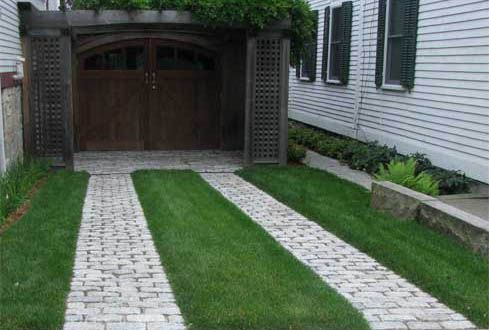

Two concrete strips for the wheels to drive on, maybe brick stamped.
Gives it an older look.
