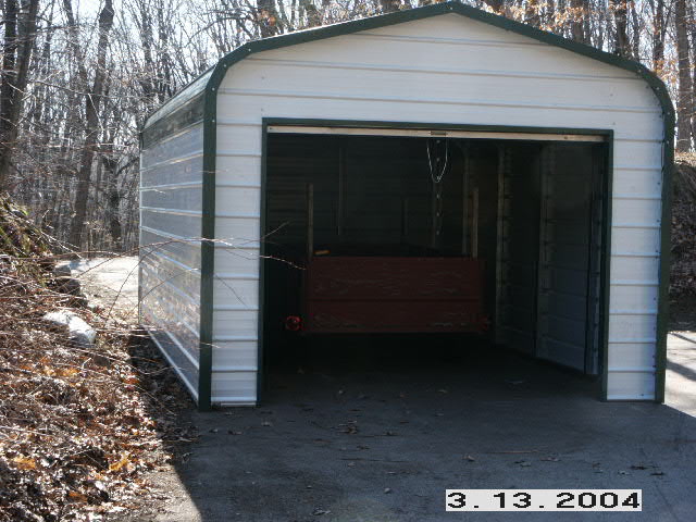

I also had one of these put in for the "Little Mule" , It is 12' by 20' with a 9' door. It works great but sweats something awful, like rain inside in certain weather. It was put on blacktop in front of y in driveway. I was told I should put down plastic or rubber and cover with gravel or whatever I wanted for floor, or put insulation in roof to stop condensation. Might be a good idea for you to put down barrier before gravel, maybe more feedback from some of the guys???? JohnJ

Nice parkng spot you got there. I've considered such but been parking the tractor under the back deck since we got it. Keeps most of the weather at bay here in bama.
seeing this though makes me want to get some thing going.
jwnge
As for condinsation try solor powered ( or just powerd if you have it) fan or some such. I was thinking along the lines of a attick style with a solor panel(if it could be done inexpensivley). It would probably move enough air to cut down on the temp swing depending on the amount of sun light it gets hit with. Fan + air vent has worke d well for me in the past on exterior mounted electrical panel with electronics in them. Just leave the fan on all the time or put it on a attic fan therostat.
