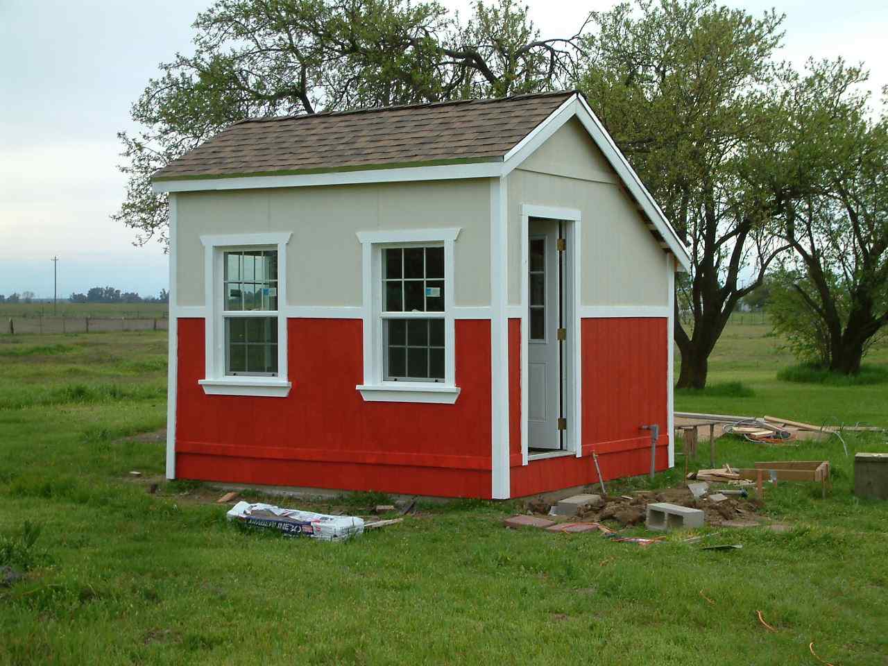

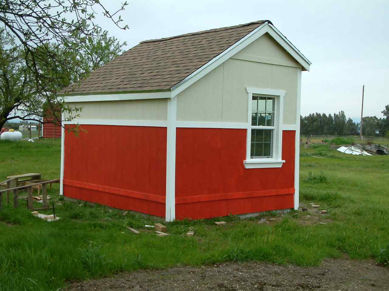

These plans aren't expensive--$15-25. I built this 10x12 ft saltbox storage shed from store bought plans after looking for decent free plans unsuccessfully.

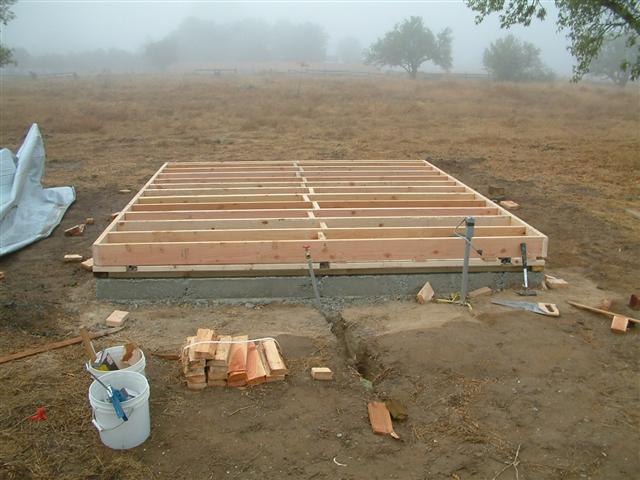

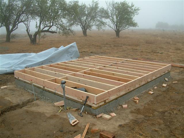

The foundation and for that shed I showed in my previous post looks like this.
I poured a concrete perimeter footing 8" wide x 18" deep (12" below grade, 6" above grade), spread gravel withing the footing and spread 6 mil thick plastic vapor barrier. Embedded J-bolts in the concrete to attach 2x8 sill plates (pressure treated) and installed 2x8 joists on 12" centers with appropriate blocking.
