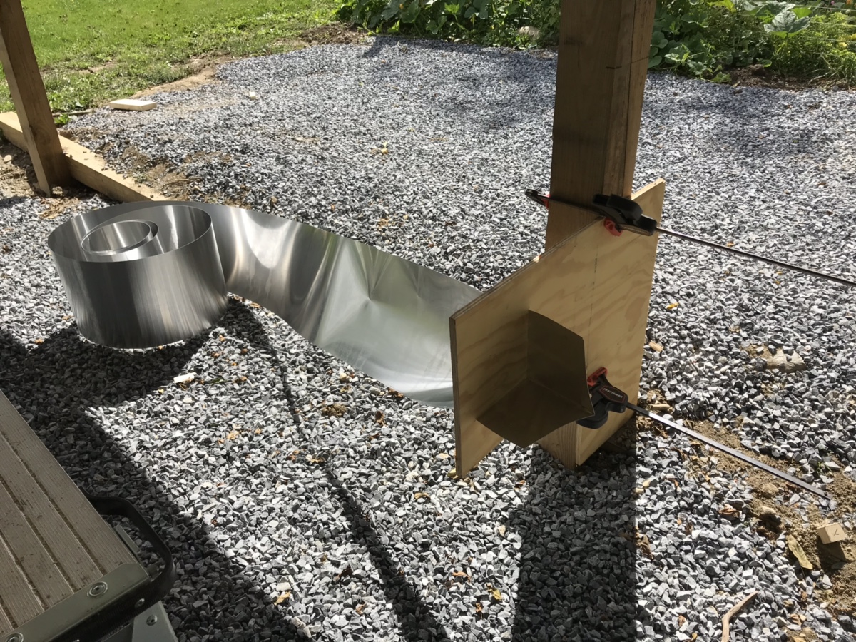

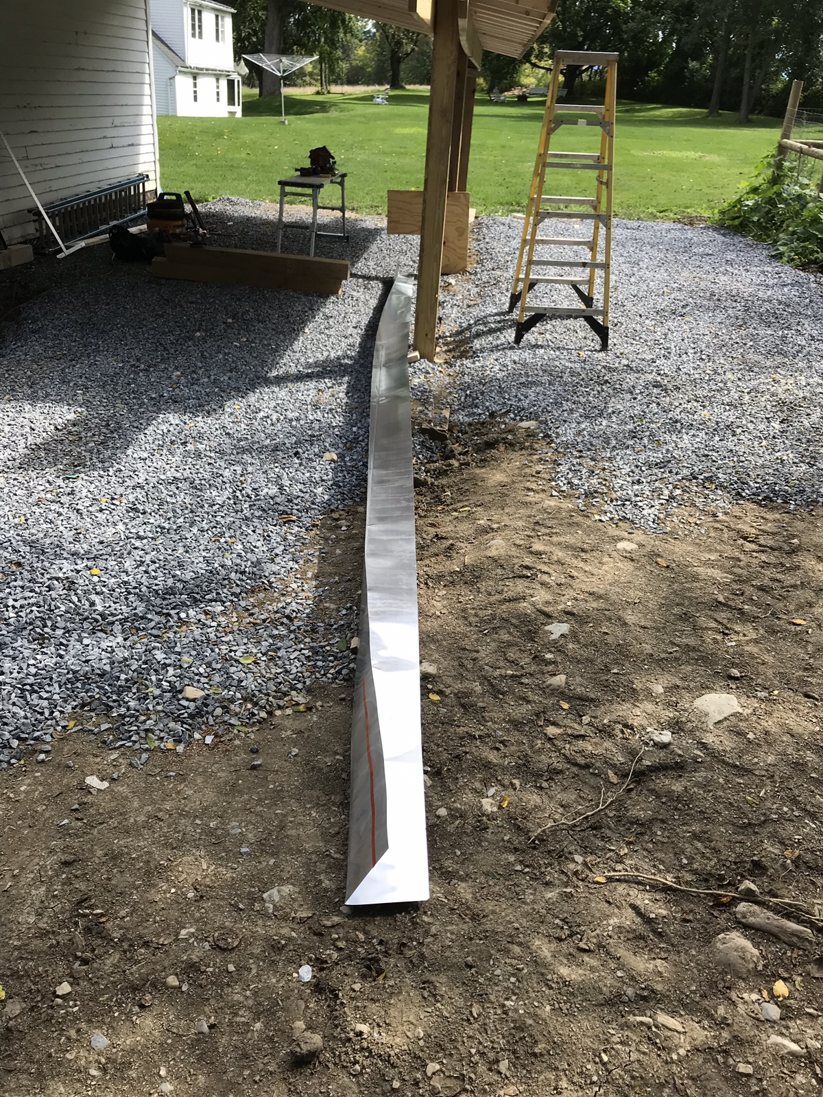

Well, an early start today got most of the metal up but a surprise visit from the “inspector” who insisted on testing the “Ninja Warrior Obstacle Course” has delayed progress.
I did learn on the internet this trick for forming the flashing. This rates right there with putting a magnetic strip on the back of the tractor to hold pins!
I did get the flashing nailed up under the eaves as suggested.
What’s the right way to do the bottom edge that lays over the metal roofing? I think foam closure strips but also read of cutting on top of each rib and forming down with sealer. Sounds like a lot of work.
