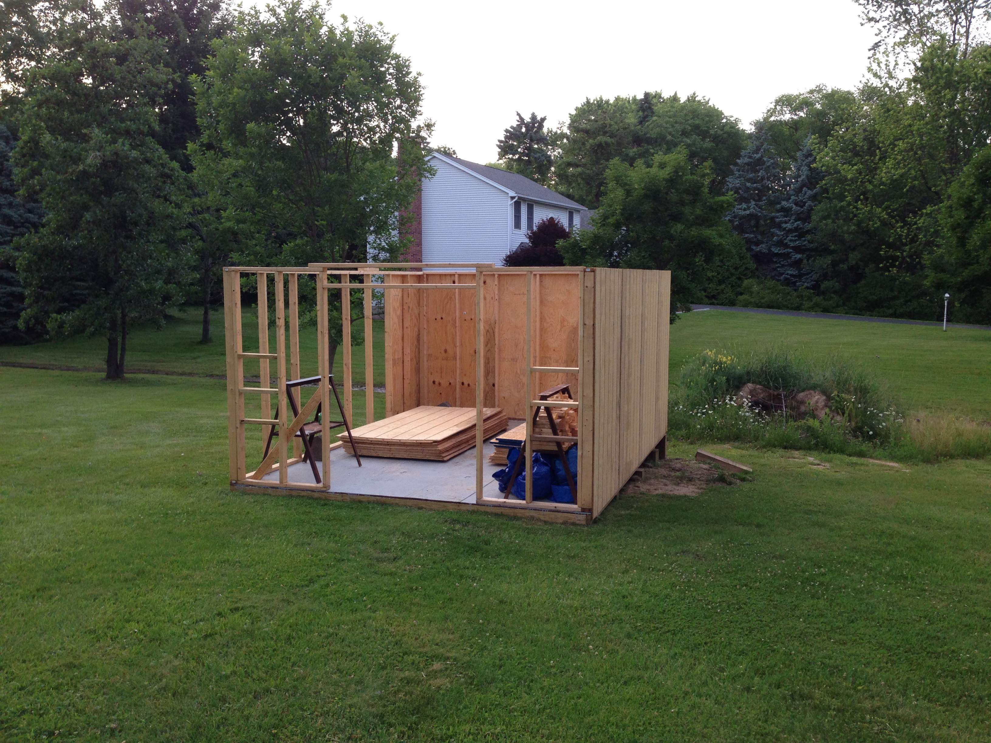

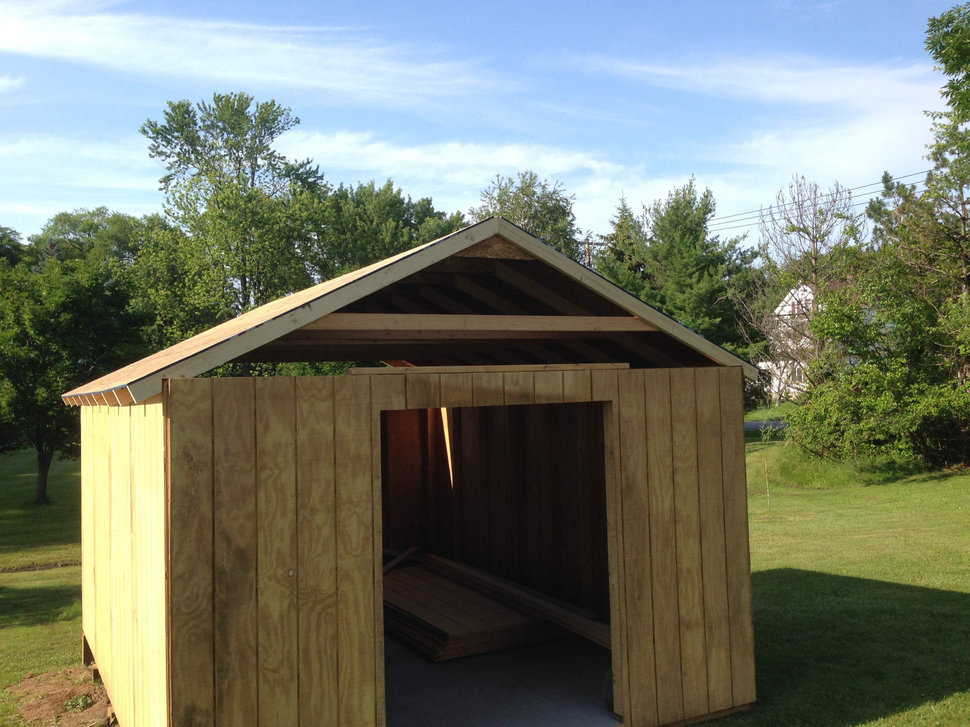

It uses rafters that are built on site (by me) using two by fours with gussets at the peak (9 of them). There is also a cross brace, I think the proper name for it is a collar beam, on the odd numbers. I may add the collar beam to the other 4 rafters just to be safe. A couple of extra two by fours is pretty cheap insurance.
Looking good so far. I started on the 12x16 foundation. Using 6x6 posts in a 4' by 4' grid. Lots of holes, but taking it a few at a time.
