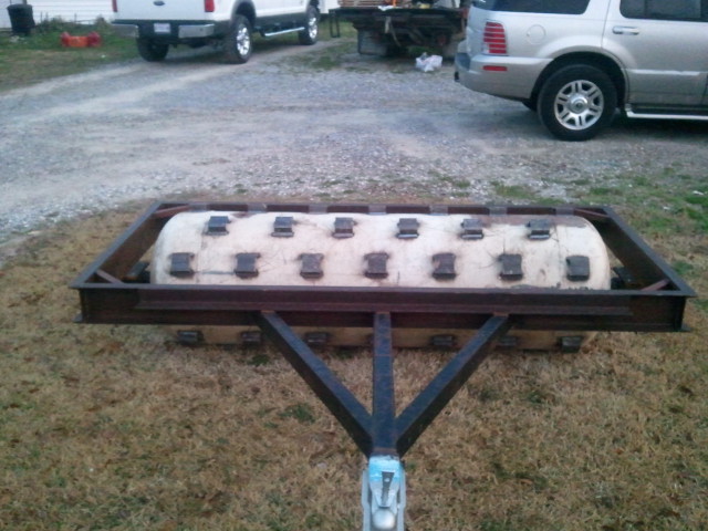

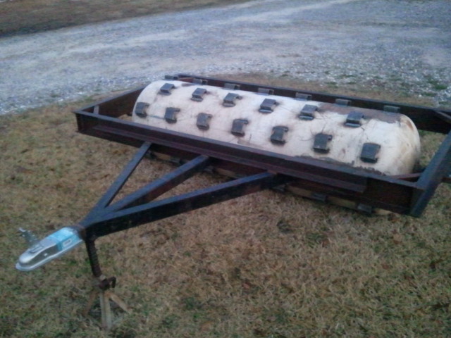

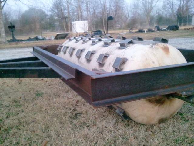

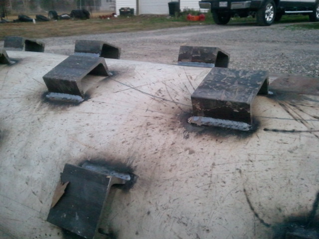

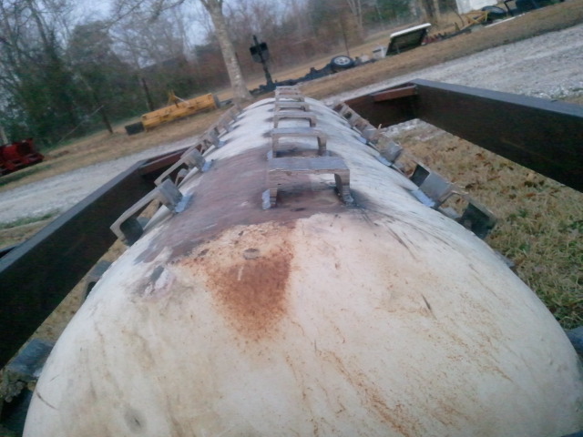

So i finished my sheepfoot. The tank is about 2.5feet tall and almost 7ft long. It is 1/2" thick . I used a 7.5' 2"round stock for the axle. The feet are 3"channel cut 3"square. I have a 1" hole in the tank to fill it with water. Haven't used it yet but will next month. Ill just use it for my own projects and not on a commercial basis. Let me know what you think. . .The good and bad.
Thanks
Brian

WOW! Very nice job. :thumbsup: Should have painted it yellow. :laughing:
My only suggestion would have been to make the feet 2" x 3" x 4" tall.
PS: You sure can run a beautiful bead :D

Brian, not to be derogatory, but I think your roller will not work well. The open feet will collect mud/clay much worse than if they were filled solid. Once they get filled with clay, the amount will increase and a solid layer may fill in between the feet. I like your idea, I just think it needs feet that don't have voids that will work like claws. You might put a very stiff brush on the front to clear mud also. Either/both would greatly improve that sheepsfoot in my opinion. You've done an awesome job. I'm amazed for sure. I just think it needs a little more to be completely satisfactory.:thumbsup:

Jim i thank you for your input. I too thought about the void under the channel, but to tell you the truth i just for tired of all the welding. Im going to try it as is and if it gives me trouble i'll clean them out and fill the holes. I do like your brush idea as well. My neighbour told me i shouldn't have staggered the feet, that way i could put a scrape between each row of feet. Live and learn right.
Thanks again for your input.
Brian

I think that looks great! If you have the clearance I think you could really improve its effectivness by welding some 2.5 or three inch round stock, as long as your space will allow, to each one of your square blocks, you could probably get away with heavy wall pipe which would be easier to come by, and the would just plug with dirt anyway.
