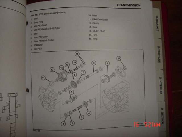

M-F SCUTs actually do have a "clutch assembly" in the PTO engage mechanism-- but it ain't much, and there's no way to engage it gradually. It's called a "clutch pack" IIRC. It sounds like it's slamming in, but that's the way it is....
You can see it below, #12. Kinda like a motorcycle clutch.
