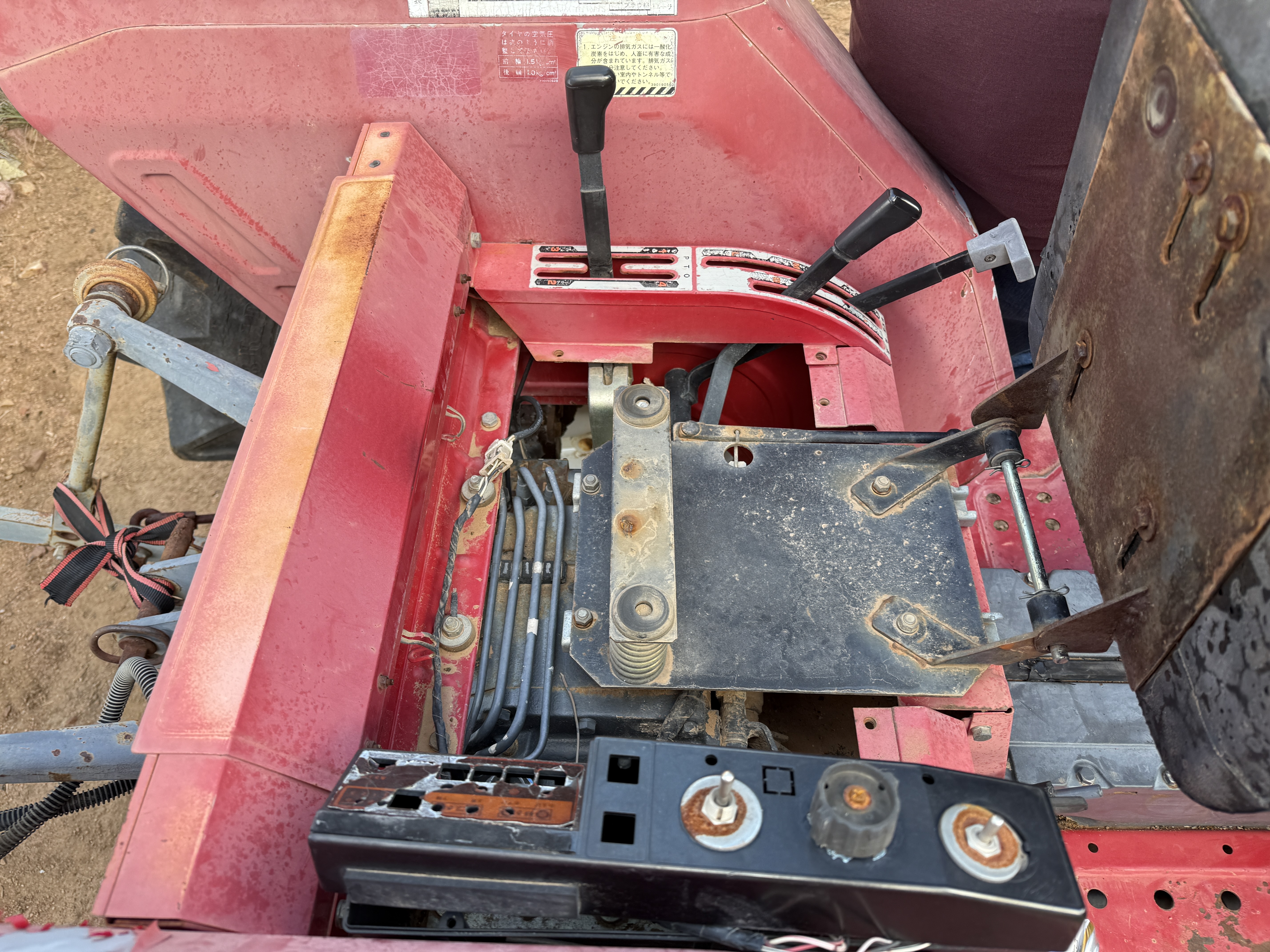

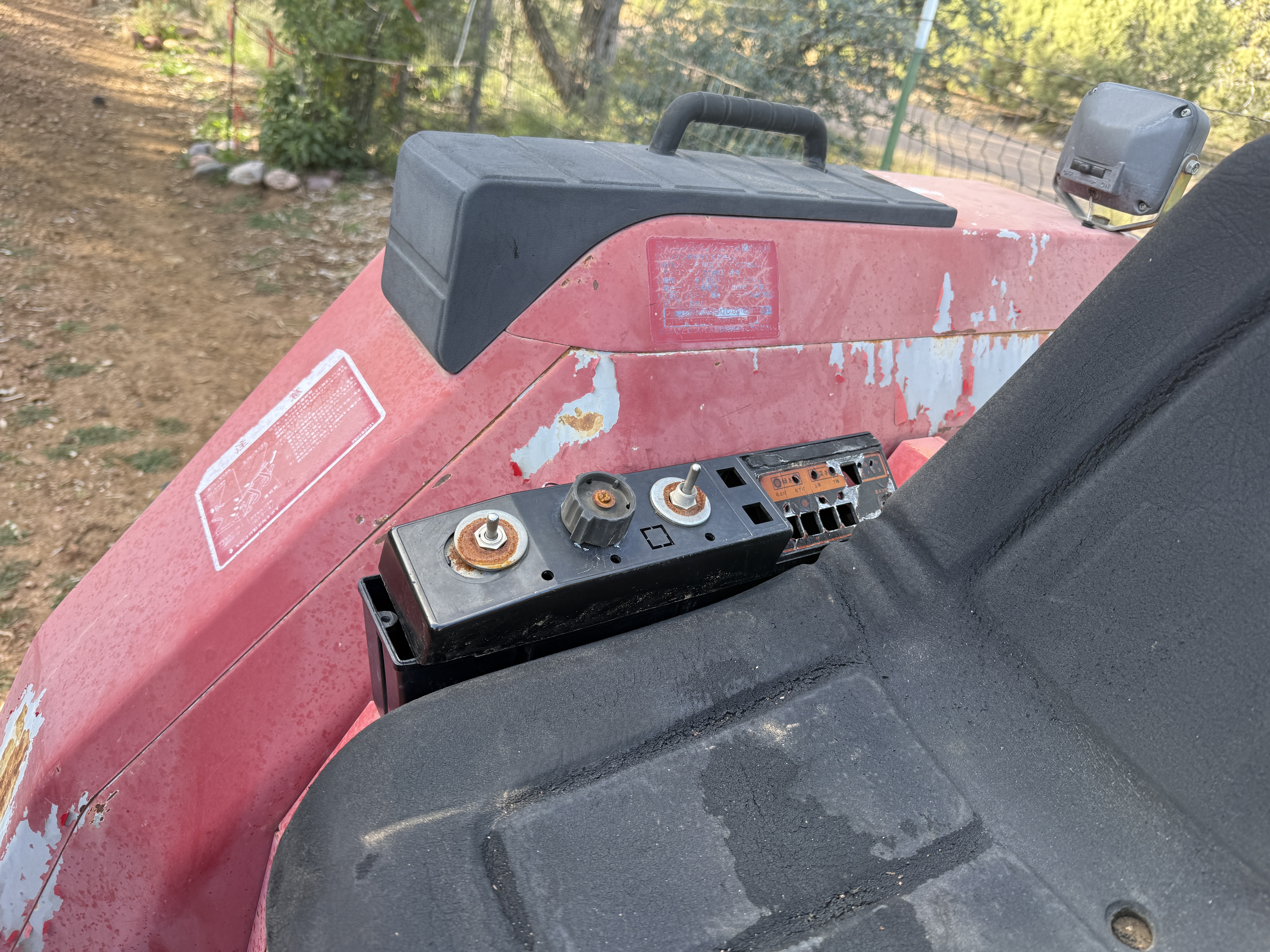

Buck
Can you help me out. I have a D23F in very good condition with under 700 genuine hours. The lift arms will not lift correctly using the electric over hydraulic switch. They lift so far then judder. Cannot get them to lift by manually pressing the solenoid. Can lower the arms by manually pressing lowering solenoid. How do we remove all the electronic box stuff and leave only lift and lower and lift arm hydraulic cylinder adjustment? Do you still have a schematic for this tractor.
Doug, were you ever able to get schematics or any info on rebuilding the electronic control box for the electronic 3 point on the D23F? I have to rebuild mine too. Nick
