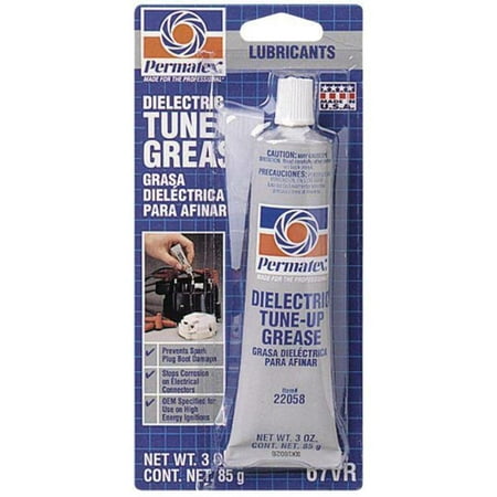

That's one of those gremlins that is hard to find. I had a Ford Probe that was having starting starting/charging issues. The battery should have been good, and I cleaned the battery posts and terminals. I took it in to our hometown shop - you know the kind that is competent, honest and never does more than needs to be done. It turns out, I had replaced the end of my battery cable, but didn't use dielectric grease. There was corrosion in there I couldn't see. Strange things happen when different metals and electricity meet. I have changed battery cable ends many times before without dielectric grease with no issues, but this time it failed. Glad you found your answer
Yes use dielectric grease, it keeps moisture and oxygen out of electrical connections that cause corrosion....
No-ox-id is used almost exclusive telecommunication industry on almost every electrical connection, even ground bonding.... I use it on all my battery connection and never have corrosion issues...
These are world's worst battery cable repair if not done absolutely properly and protected with anti corrosion compounds... Personally I would not use them and just replace cable... Your results may be different....
